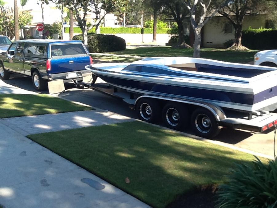

I have been working on this for longer than I want to post, have a couple threads on some other sites going already and I have really enjoyed and benefited from the feedback and insight this boating community provides so I decided to test the waters over here as I am seeing a lot of V Drive cruisers on this site. This is my third boat to restore, the last two have been Sanger flats and I have not gone to the depth of restoration as this thing. Complete trailer rebuild, split the boat new stringers bulk heads, strut relocated, extended center strakes etc etc etc....A ton of work for an old boat but also had a blast doing this with my Dad, Uncle (not blood but he is my family) Brother in law and friends. on the down hill side doing rigging now targeting mid late summer completion.

Beautiful job. How did you determine where to move the strut to and how much to add/remove to or from the strakes? I've had the little voice in the back of my head tell me to someday convert the cruiser from jet to V-drive, but you have a lot more energy and gumption than I do. That looks like a lot of work and you started with one that was already a V-drive.
Lots of hard work there. How far up did you move the strut and how far down did you extend the center strakes?

I had been talking with a few guys with similar boats one in particular was a howard VD Cruiser I believe out of Virginia. He did the same thing and i believe went an inch more than I did. I moved 8" forward, no science just advice and experience from a good friend who had done this over the years to several boats. We brought the center strakes back just under 4' they now stop just before the strut. These boats are bow heavy and we wanted to try and lift it as much as we could. Looking forward to see if all the work pays off, I have a friend with the same boat looking to see if there is a performance change, should do something.
