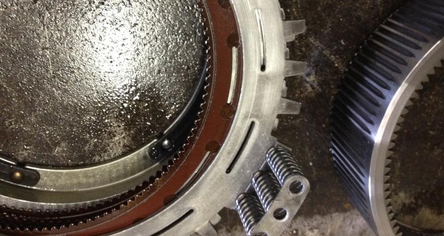

    Here are some pics from a one ton 200k mile utility 4x4 work truck... The trans was still working well but the owner was noticing hard UP and DOWN shifts...

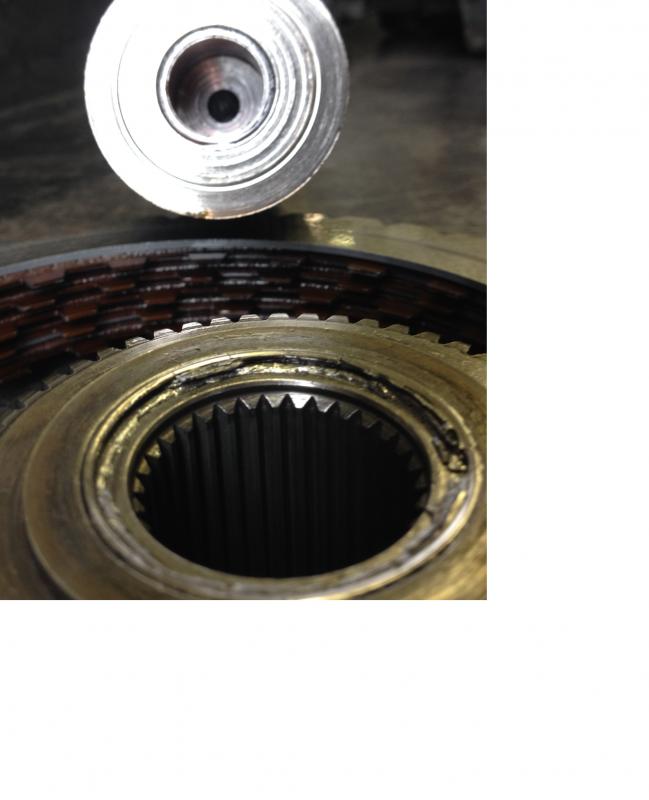

    There was a needle/roller thrust betwen the low/reverse gear shaft and the output shaft that failed (common failure point)... The frictions/steels looked like new... I suspect that the metal in the system caused the pump housing to start to fail/wear prematurely and start to loose pressure causing the shift condition...

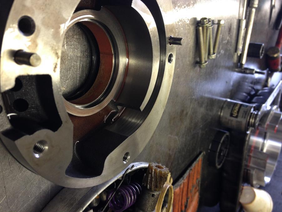

    Worn pump housing and failed needle/shaft face (where they idle together / overrun each other):

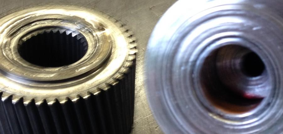

    The face of this shaft should be flat smooth/ground surface. The face of the gear should have a the needle bearing that failed, and should lift right out (but its gone)...
    Name:  output and low gear_reverse shaft mate.jpg

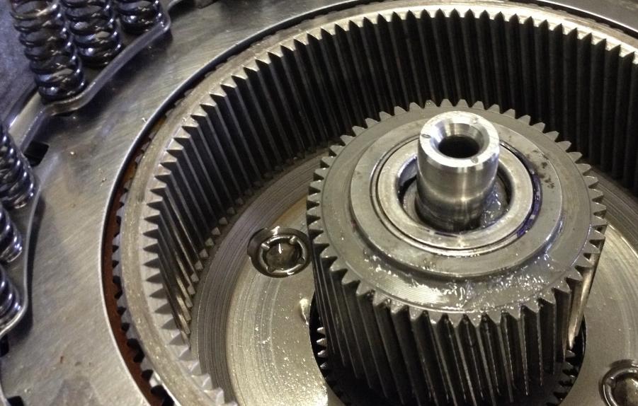

    Bad part:
    Name:  bad cluster.jpg

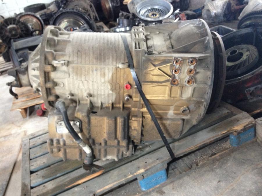

    One clarification on this Allison failure, this transmission is from a 4x4 and the needle thrust that failed is smaller in the earlier version of the 1000 that has a transfer case hanging on the back end. The 2wd versions and the upgraded 4x4s have the larger thrust bearing in that cluster for the output shaft to ride against...
    The BIGGIE size...
    Name:  allison BIGGIE.jpg
