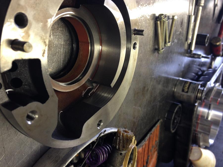

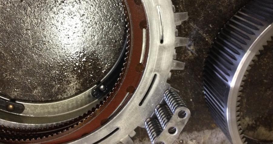

Here are some pics from a one ton 200k mile utility 4x4 work truck... The trans was still working well but the owner was noticing hard UP and DOWN shifts...

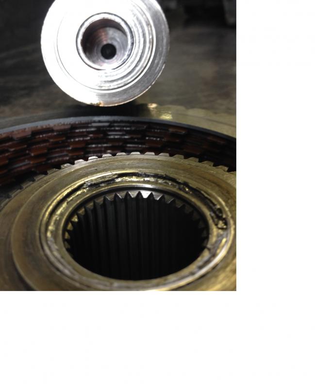

There was a needle/roller thrust betwen the low/reverse gear shaft and the output shaft that failed (common failure point)... The frictions/steels looked like new... I suspect that the metal in the system caused the pump housing to start to fail/wear prematurely and start to loose pressure causing the shift condition...
Worn pump housing and failed needle/shaft face (where they idle together / overrun each other):
The face of this shaft should be flat smooth/ground surface. The face of the gear should have a the needle bearing that failed, and should lift right out (but its gone)...
Bad part:
New thrust:

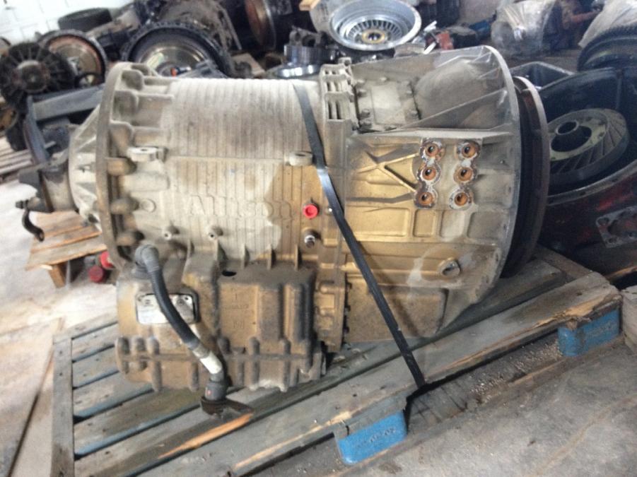

Most of their work is on trash trucks with a BAZILLION miles on them... THese little 1000s are about 1/3 the diameter for the frictions/steels/torque converters...
Hey 2MM.......all I can say is "You know your shit".....very cool!!
The BIGGIE size...
