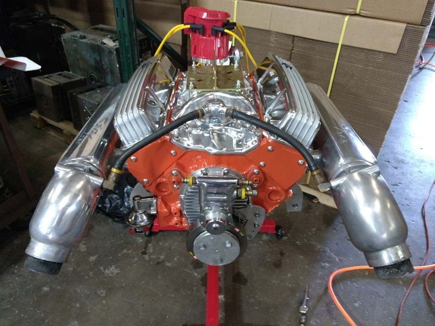

    Thought I would let you know the current status of the 1966 Howard.
    Pulled the 327 and purchased a built 350. Comp cams provided the marine cam and associated hardware. Various bits from local and Ebay sources. Painted Torch red. The engine has Dart Iron eagle heads
    and was a fresh rebuild but the last owner either had too large a carburetor or wrong cam as it would not idle. Pulled it and went big block so it ended up in my hands. I pulled it down to the short block and saw nothing that would
    give me concern.

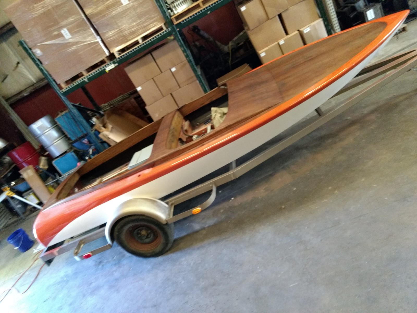

    Here are a couple of shots of the Howard getting the deck sprayed in Orange. Thought that the Orange with the dark Walnut would be a nice combination. Besides, having an Orange boat in Tennessee is not a bad idea.
    The deck cracks were a real pain to get right and it has taken more hours than I care to think about. I would, however, if I ever take on a similar project would use Polyester for this edge repair over Epoxy. The Epoxy will be fine to
    do the wood deck but it does not like sanding like polyester.
    This photos are of the first pass in base coat. Once down, I wet sanded it in 220 grit to make sure everything is flat and ready for clear. Tomorrow we go back to a couple more coats of Orange then three coats of clear.
    With that complete, we then go onto the wood deck for staining and epoxy and varnish. So far, it's going well but probably won't see water till next year.Name:  howard in orange #1.jpg

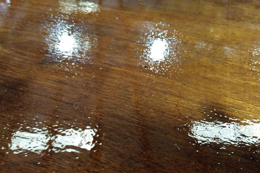

    Name:  Howard dark walnut high shot.jpg
Size:  391.5 KB Got the deck repaired and a coat of dark walnut stain. Will need to let it sit for a week or two to allow the oil to evaporate then its onto epoxy and varnish.

    A little learning curve when it come to epoxy resin. Attempted to coat the rear section of the Howard and the resin wanted to pool and gather rather than stay a uniform coat. Sanded it back to a uniform film and by the way, Epoxy does not like sanding like Polyester. Contacted total boat to find a solution and they recommended their Totalboat penetrating epoxy. This is a very thin resin that is designed to soak into the wood and fortify the wood fibers. Since we are in the midst of the weather changing, I purchased the cold weather formula and as luck would have it, Tennessee has been quite warm right up till now so I have had to wait for cooler temperatures.
    Once I get the epoxy down, the next coats (4-5) will be two component clear varnish.
    The Upholstery is complete and ready to go and the engine is ready. I purchased a Quick Fuel 650 CFM marine carburetor and had to jetted and flow tested based on the cam, heads and bore so it should be close right out of the box.
    Promise to keep you up to date as progress is made.
