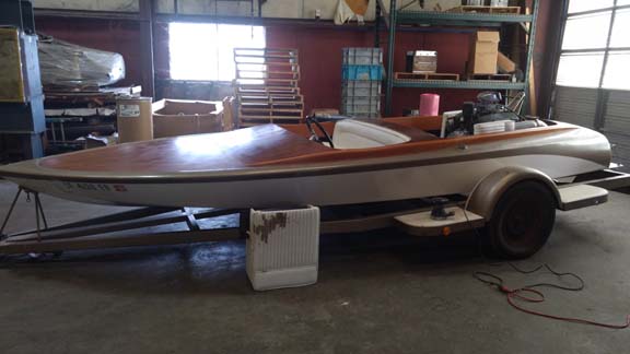

Size:  39.8 KBI just purchased a 1966 Howard Walnut deck V drive ski boat. Has not seen water since 1984 and was covered with a tarp for years. The gel coat was in pretty bad shape on the walnut deck but a little elbow grease and lacquer thinner brought most of it back to life. Will need a little repair and new top coat but the boat floor and stringers are in amazing shape. It's got a 327 Chevy but its been bored to .060 so it may end up being an anchor. Bottom is perfect. Some delamination between top and hull but not too serious.
    I am new to V Drives. This one has a Thorobred and that may have to go also. Not sure.
    I ran D class Outboards in my youth and had a Sidcraft Utility hull with Merc. 50 HP. Wish I had it again but I doubt my knees would take that abuse again.
    Here is a shot of the boat.
    I am sure I will have a ton of questions as this is my first time and this site appears to have all the experts as members.

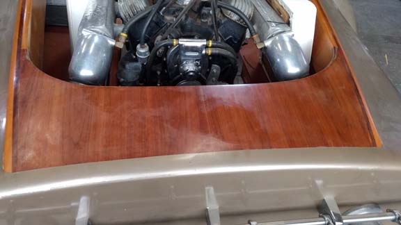

    Here are some shots of the Howard after getting the upholstery out of the boat. My assumption is the .060 over 327 is probably going to need a new block. 327's are not easy to find but 350's are a dime a dozen.
    This engine has Corvette heads so they may need to rebuilt and saved. Thoughts?
    I'm told the V drive is set up at 9 degrees. When I uncouple the drive and rotate the shaft the strut screams lube! Plan on taking the shaft out and check for bent shaft and inspect the bushings in the strut.
    Here is my problem. I did not put it together and need to know what first steps to break everything free.
    Do I break the shaft coupling and mounting for the V drive and pull it forward to expose the drive shaft flanges or is the drive shaft splined to the engine an pull the engine rearward?

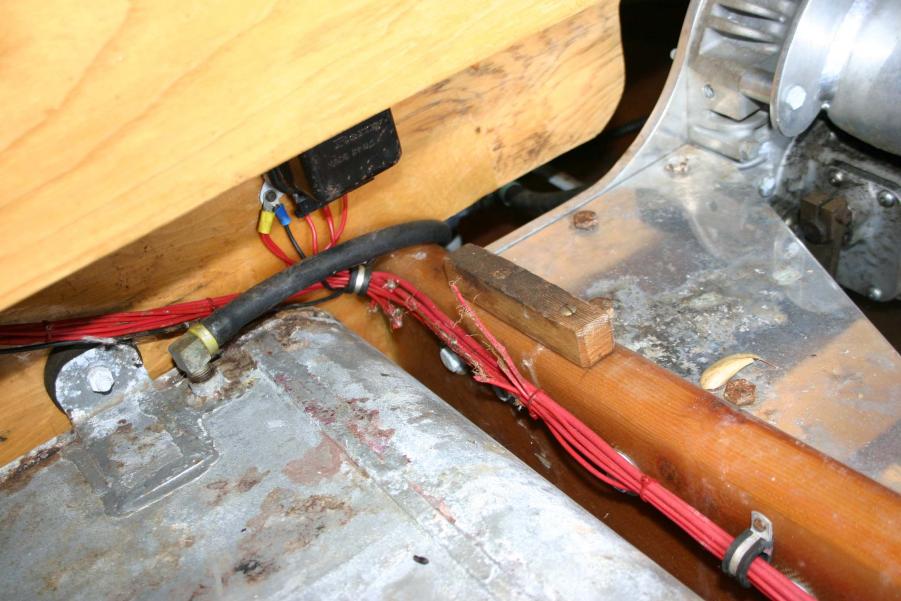

    Wiring
    The wiring appears to be either eaten by mice and got hot. Seems a bit unlikely that mice could eat the copper so I am assuming that something went wrong at some time. Additionally, the wires used were automotive grade and not marine and do not follow the color coding spec for marine use. My plan is to rewire the complete system. I have not been under the dash to see if there are proper fuses to protect the system. Any thoughts?

    WOW, she looks VERY intact/original... I would get her on the water first thing and see how you like her before you rip her all apart for resto/repairs... Maybe back it into the water somewhere close after you get it running to ensure the shaft seal is decent enough for a few outings...
    ALSO, a new impeller on the water pump is a must...
