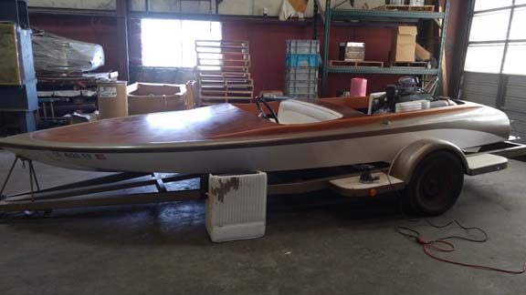

 I just purchased a 1966 Howard Walnut deck V drive ski boat. Has not seen water since 1984 and was covered with a tarp for years. The gel coat was in pretty bad shape on the walnut deck but a little elbow grease and lacquer thinner brought most of it back to life. Will need a little repair and new top coat but the boat floor and stringers are in amazing shape. It's got a 327 Chevy but its been bored to .060 so it may end up being an anchor. Bottom is perfect. Some delamination between top and hull but not too serious.
I am new to V Drives. This one has a Thorobred and that may have to go also. Not sure.
I ran D class Outboards in my youth and had a Sidcraft Utility hull with Merc. 50 HP. Wish I had it again but I doubt my knees would take that abuse again.
Here is a shot of the boat.

very nice projectkeepsake topolino, welcome to HB, where it all started
post up some photos of the Vdrive if you don't mind, there is plenty of expertise here to answer most questions... IF the folks here don't know, we know how to get the technical details your after...

Prop shaft seal should be a easy deal, we have several good resources here for dripless couplings & tech... Let me see if I can summons one for you to ask questions, in the mean time it would be good to see some pics of the existing coupling and the strut from the bottom side of the hull too (in addition to the drive).
WOW, she looks VERY intact/original... I would get her on the water first thing and see how you like her before you rip her all apart for resto/repairs... Maybe back it into the water somewhere close after you get it running to ensure the shaft seal is decent enough for a few outings...
ALSO, a new impeller on the water pump is a must...
WANNABE / FC Pilot & the Millers (on here) could probably spec out a really sweet SBC for you that wouldn't break the bank IF the 327 can't be salvaged... They have a cool new small block project that just hit the water... >>>> http://www.wannaberacing.com/sk51.html
