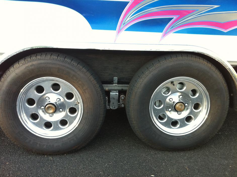

-Check your wheel bearings. This doesn't mean shoot some grease in the buddy bearings and call it good. Jack up each wheel individually and give it a spin. Check for excessive resistance or roughness. Also try to wiggle the wheel from side to side. There should be very minimal play if any. This is also a good time to check trailer brakes for dragging and tension.
-If the grease looks very watered down or dirty it is best to disassemble the hubs and check the bearings. Repack or replace as needed.If everything checks out give each bearing buddy a few shots of grease. Don't get carried away. Just pump the grease in until the plunger on the bearing buddy starts to move and your done.

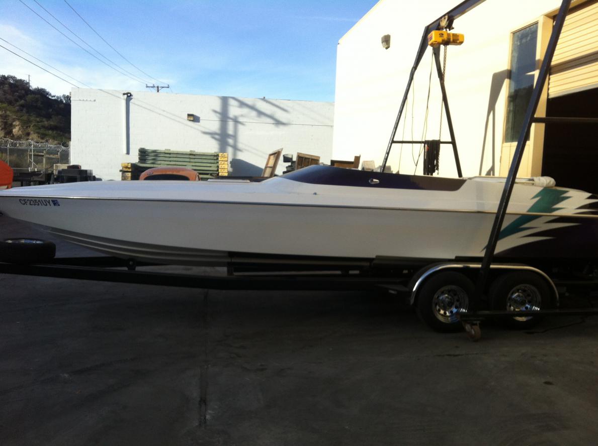

Forgot to mention we also moved the axles back 14 inches on that last trailer. Customer was complaining about poor handling above 50 mph and it was due to a lack of tongue weight. Most trailers don't need these kind of repairs but I believe this trailer was built for a different boat and somehow ended up under this daytona.
