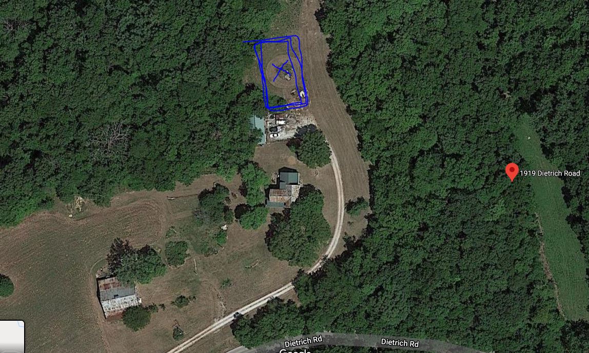

    I'm looking at a 4/12 pitch truss roof, some attic trusses, some conventional and some Scissor trusses for a vault area (for a lift). 50x80 open/clear span with 2x6x12' frame walls.
    My building site falls off about 6 foot from the s.e. corner to the n.w. corner so I'm looking at approximately 15K for a 8 foot tall concrete wall on three sides and then 6 feet of compacted limestone screening fill tapering off to nothing at the s.e. corner... I may even do a small cellar/basement area for well pressure tank/furnace/plumbing since we have freeze risks here...
