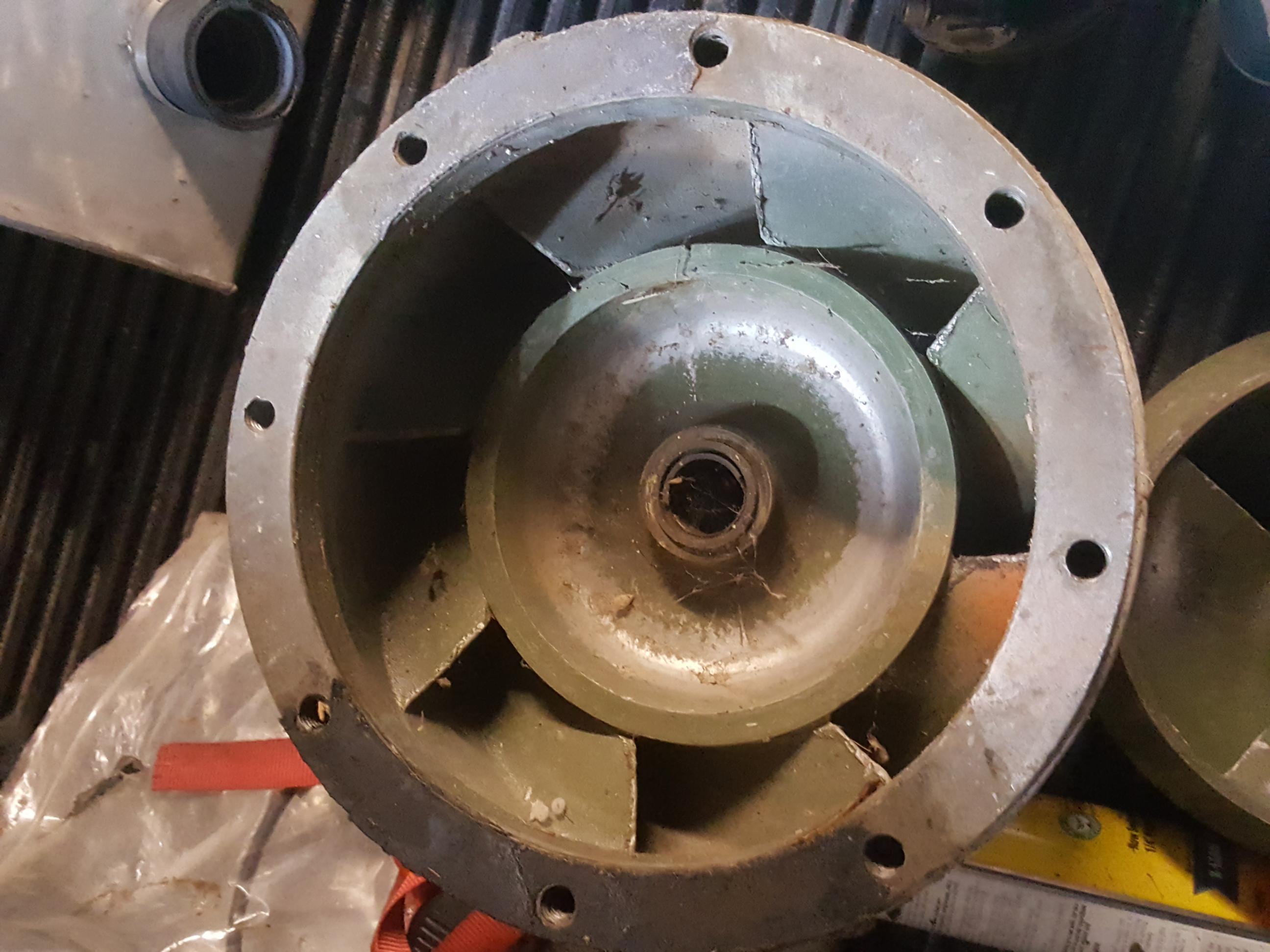

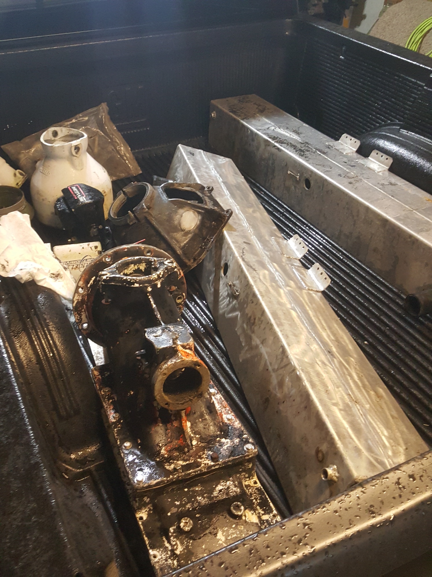

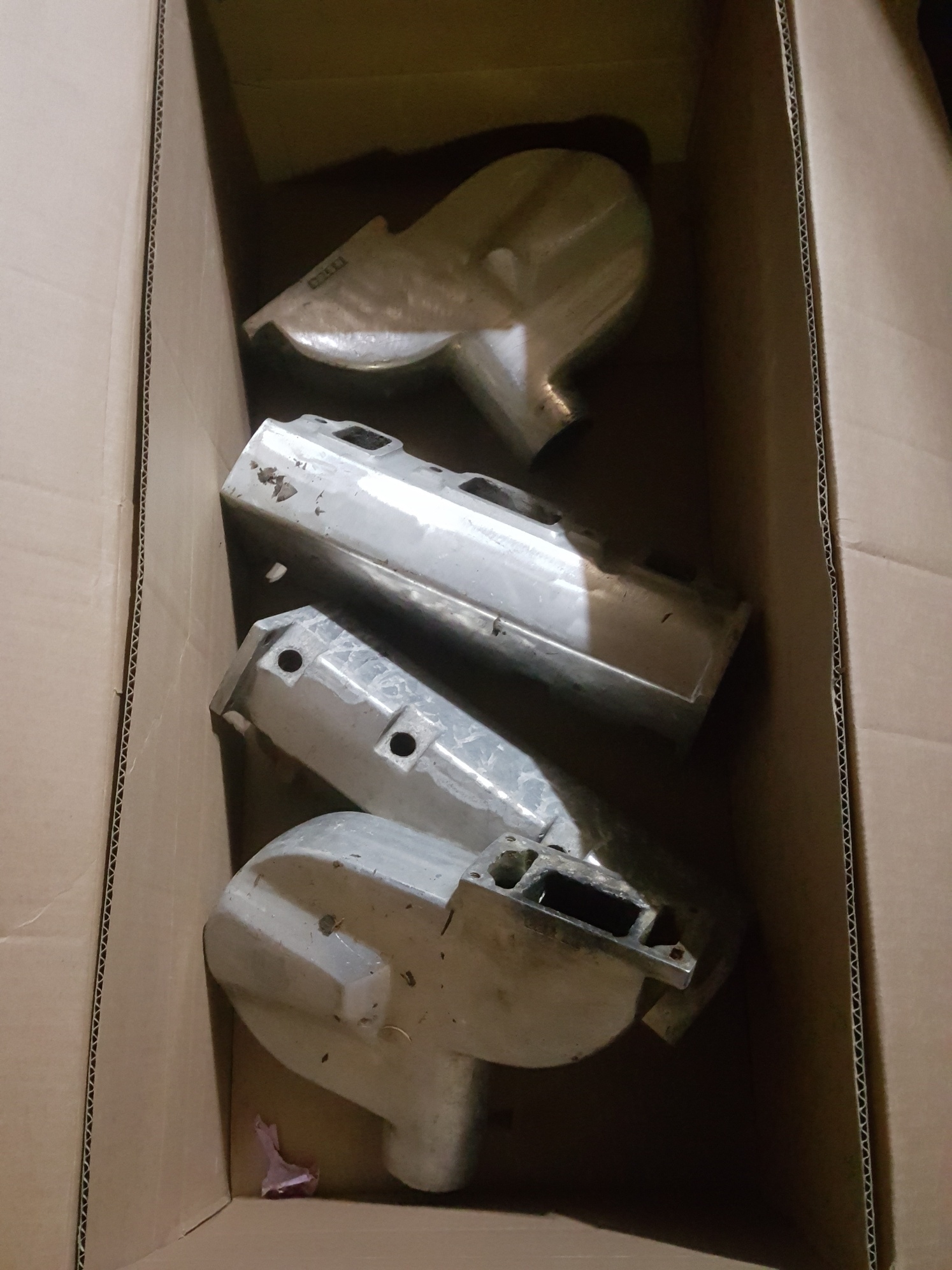

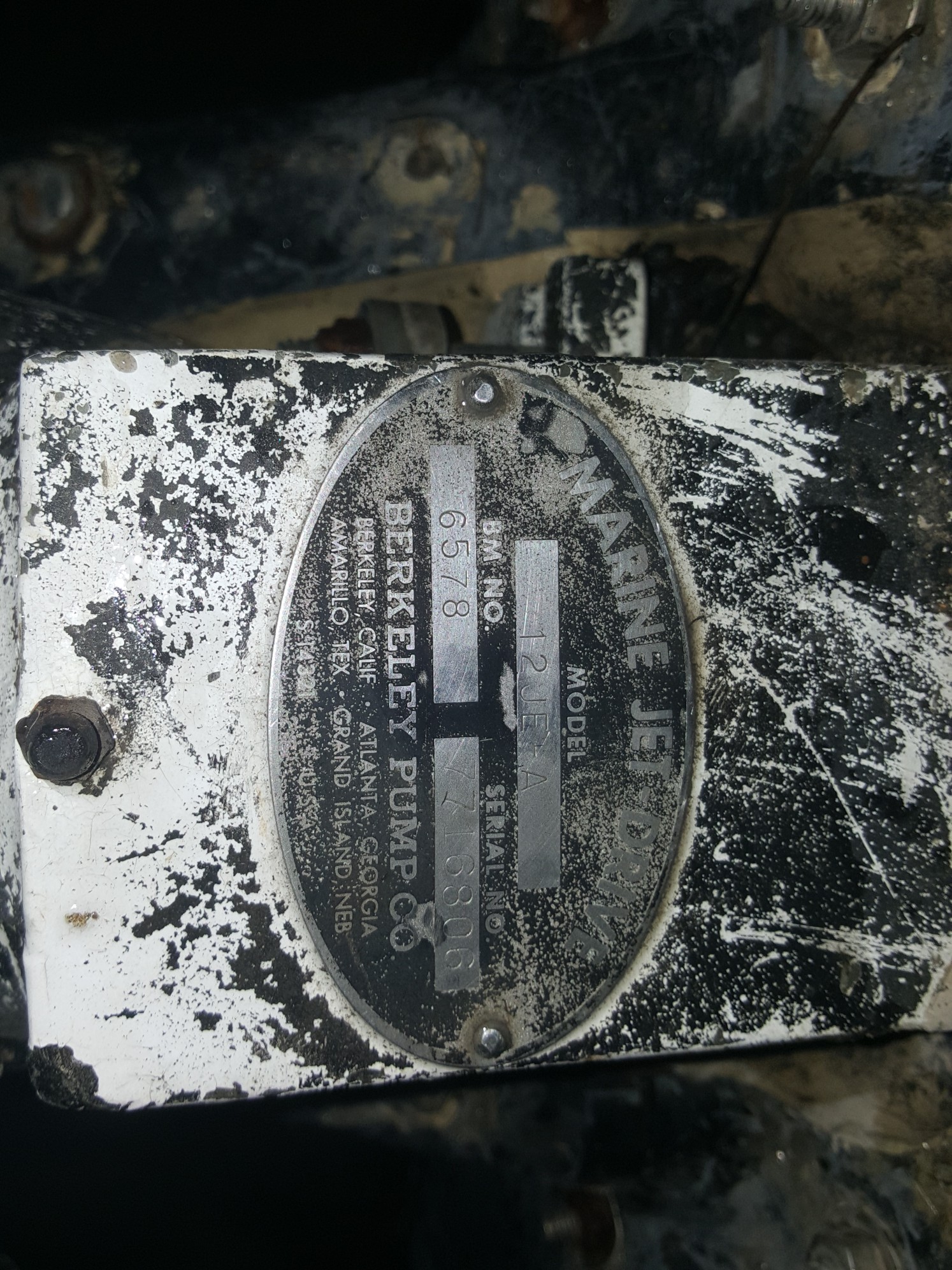

When I bought this boat the guy randomly started putting extra parts in it that "go with the boat". Im new to jet boats and to be honest, have no idea if any of these components are worth messing with.

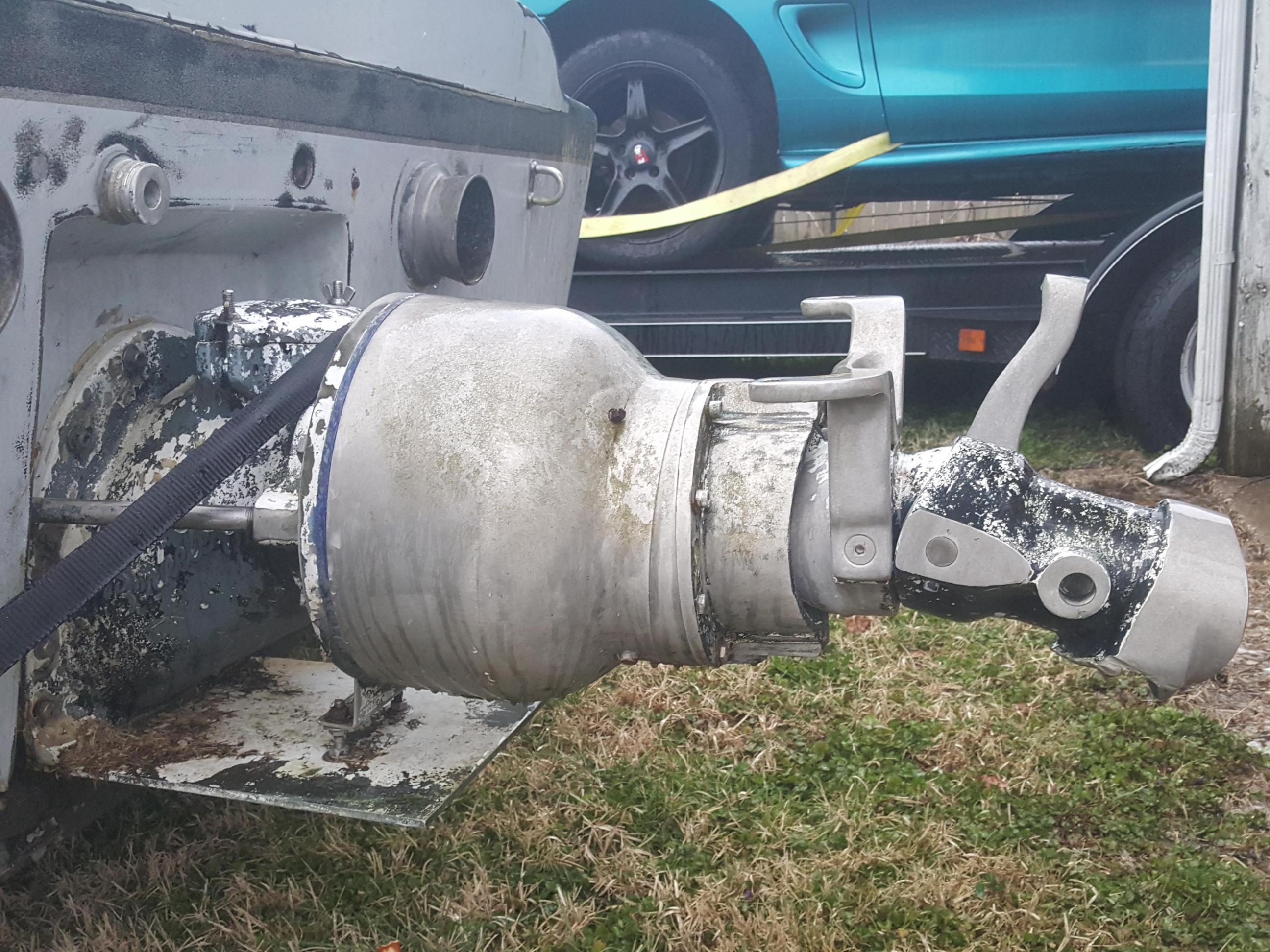

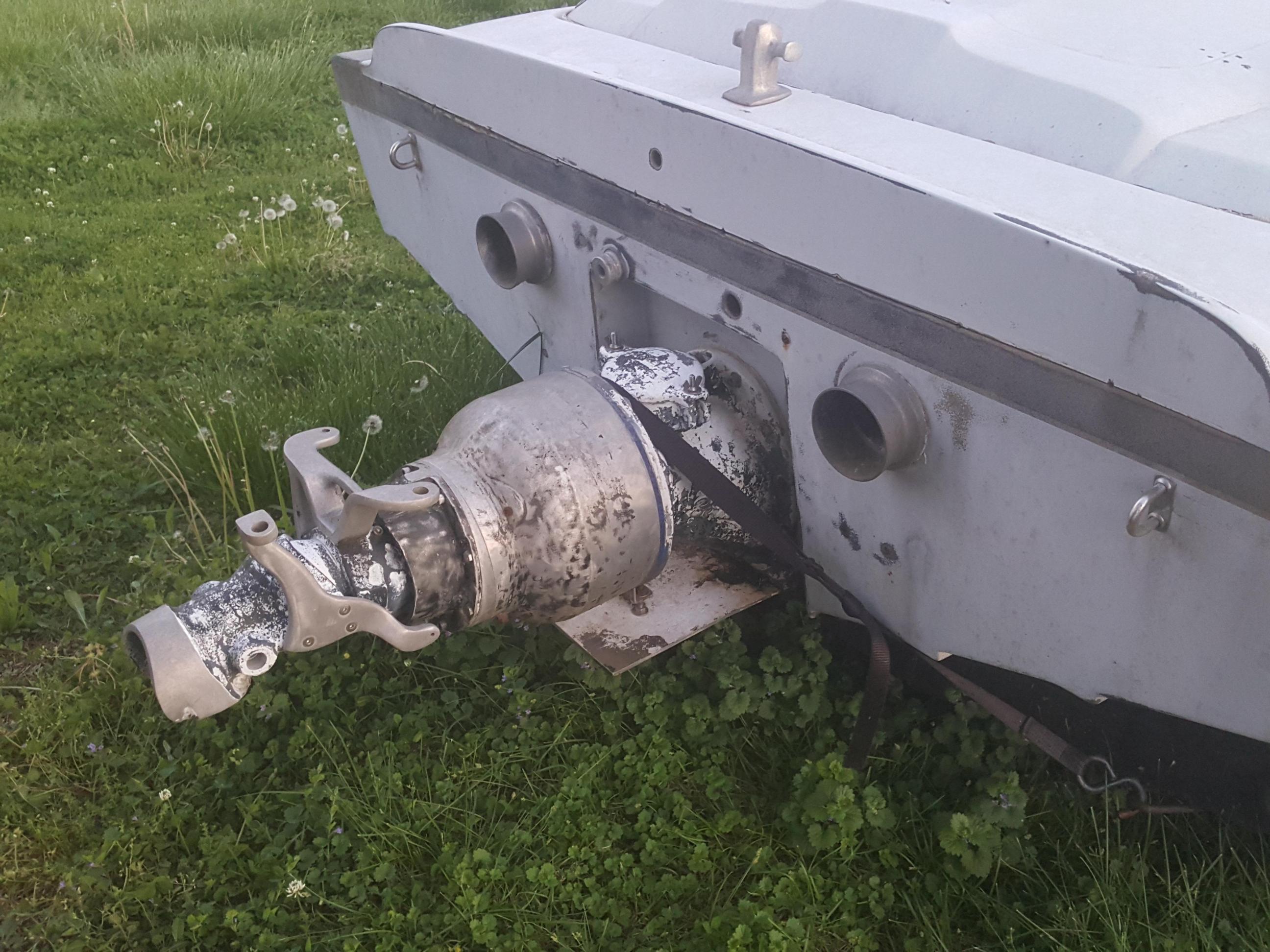

Installed on the boat is a 12JE-A pump that is supposed to be in good shape but has been "modified" according to the previous order. I don't know what to look for but I got everything for such a good deal that it really didn't matter at the time.

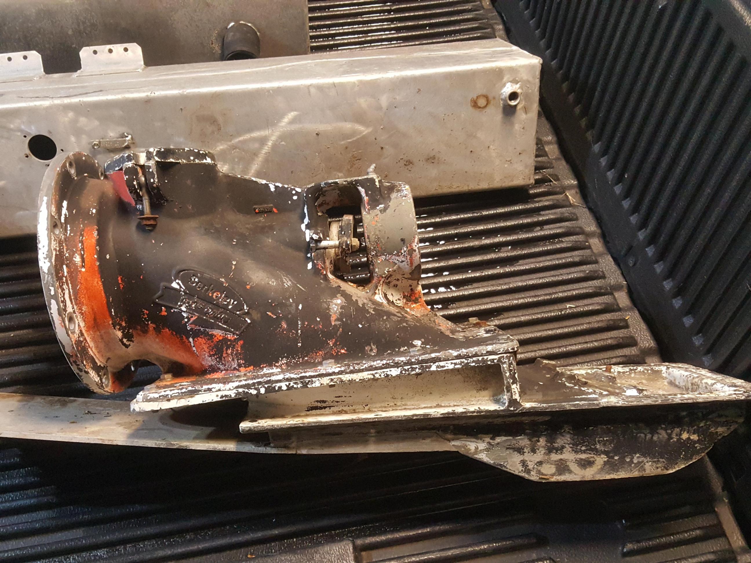

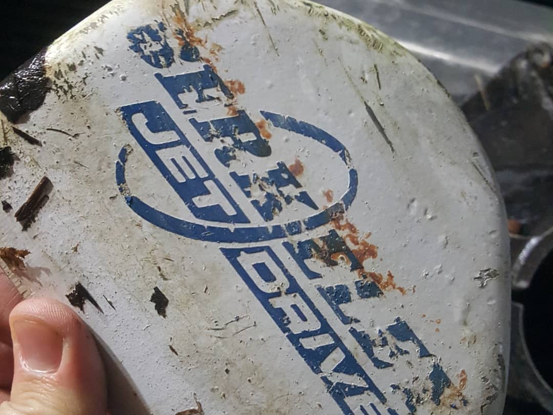

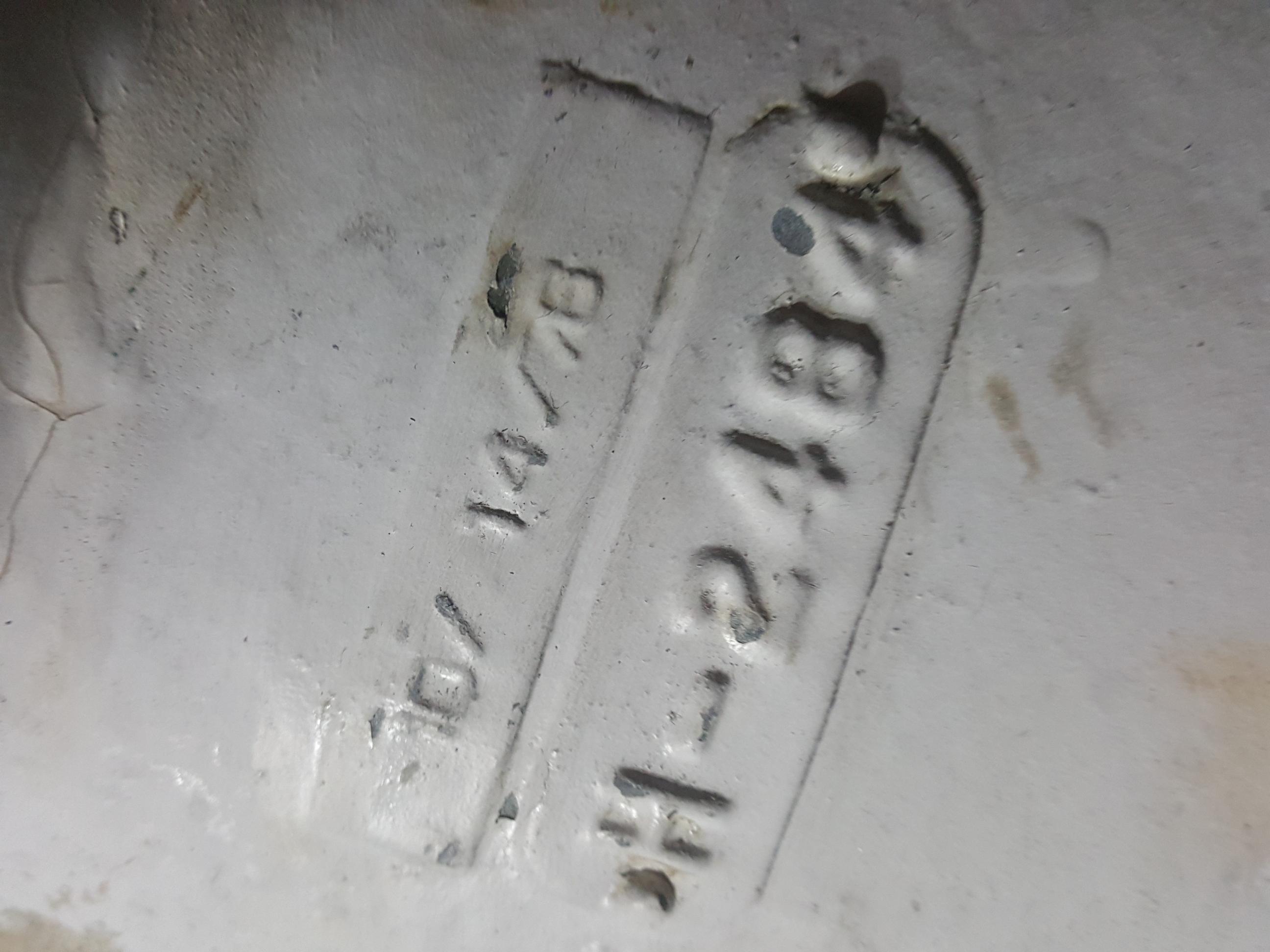

The boat originally had a 455 Olds which is long gone but he did give me the manifolds, bell housing, u-joints etc in case I wanted to go back with that power plant. I didn't pay too much attention to the other components he gave me at the time but he did give me what I believe is the remnants of a JC pump, and extra bowl, a diverter some odd and end cables etc.
Would you guys mind giving the pics a once over and letting me know what you think? Im going to assume that the pump or some components on the pump that are attached to the boat may be bad and that's why he had the JC. Either that or he just collected parts and wanted to get rid of everything. The boat needs ALOT but the price was right so any good news is a step in the right direction. Check out the pics and let me know what you think.

if your asking about re-selling the parts, no there give aways. if you need a "hobby" to fill all your free time you just found it. actually the trumpets look to be in good shape. there guys that just love restoring these things, same guys that love restoring Hot Rods, Good Luck.
Oh no. I didn't to get rid of anything until I figured out exactly what I needed and what I didn't. I just didn't know if what I had was worth using as a foundation for a build or if I was just going to be starting with a hull.
Also, I dont really see anything of the same piece twice so I was wondering if anyone could offer up some advice on which components would be best to build on.
What's on the boat is better than what he gave you from what I see in the pics. You've got the split bowl, with a wedge, which is not a big plus depending on what you're trying to do, and a diverter. That is the setup to have as a baseline. Down the road, I'd pull the wedge and put a droop snoot on as that will lower your thrust line and should give you more top end as you'll have less boat in the water in theory.
I wouldn't waste time on anything Olds in a boat. They have oiling problems, and while there are work arounds, like adding extra drain lines to the heads, restricting oil flow to the top end, you'll be time and money ahead to off that stuff and got with a big block Chevy, where parts are much more affordable and readily available. There are some die hard Olds guys out there, and the parts are getting harder to come by, so they may be worth something to the right person.
