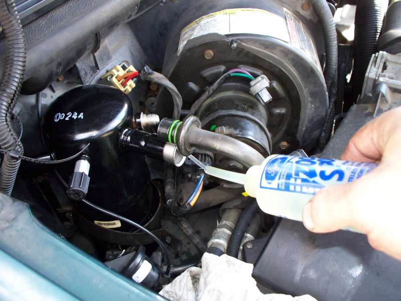

R134 I assume... Look at all of the unions and try to find a union that looks oily/greasy/dirty...
DONT use any of the "stop leak" charges, but a oil/R134 charge is good to do eventually...

Auto AC is one of my hobbies, quite often the orfice/screen gets plugged when a novice is doinking around on the system OR there is a compressor failure and the system gets contaminated... THe orifice tube is easy to change IF you can locate it
