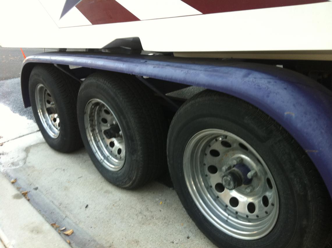

    You can see from the pictures the boat was in rough shape. It was complete and ran but definitely had been neglected.

    Once the boat was stripped I pulled it off the trailer. No point doing all this work on the boat to drag it around on a worn out trailer.

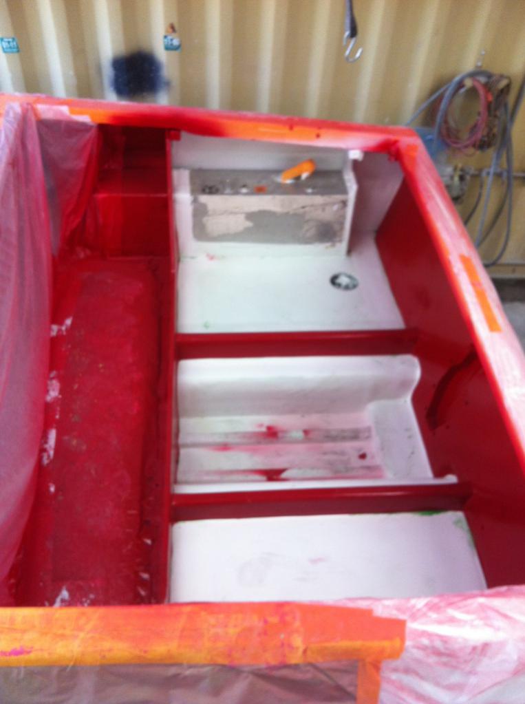

    I did not take nearly enough pictures of the fiberglass stage. The bilge was sanded smooth and all the holes were filled. The exhaust was filled and moved up about 8 inches. The dash was filled and re sprayed and the entire boat was color sanded and buffed.

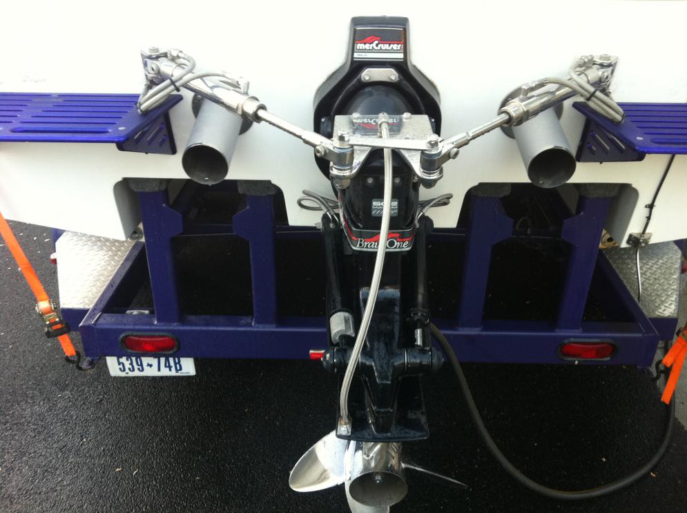

    All the hardware on the boat was stripped and clear anodized. No more peeling purple powder coat. You can see the exhaust holes have not been drilled yet. I wanted to make sure the pipes would come out above the wing plates on the box and not interfear with the swim steps at all.
    Ok, the holes are cut now. Anyone who has ever done this knows what a pain it is. A 5-1/2" hole saw will make kick your ass if your not careful.
