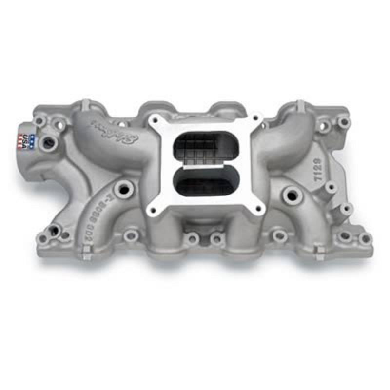

    There is an off the shelf cam that I am going with to baseline this engine, hydraulic roller, and I will use the best lifter I can afford. Intake and cam may change down the road. I am going to run a pair of TRI-Ys with custom flanges to fit the cleveland heads (already have them).

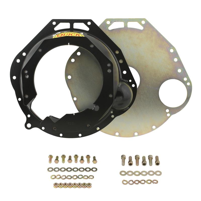

    Trans is a t56 2003 cobra six speed that is getting REgear and upgrade to viper spec parts (double overdrive .5 ratio , better forks/bronze pads, new gears). Rotating assy has to be balanced so I have to get the flywheel/pressure plate/clutch disc/hydraulic throwout/slave.
    I have to get the cam plus these two parts to resume forward progress before I can start mock up and make a few little updates on the block before finish hone on the bores...

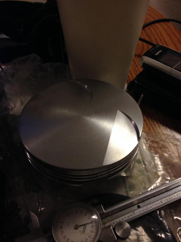

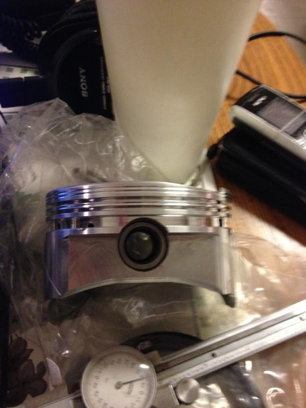

    The slugs for a 351C head on a 289/302/331/347 are not your every day off the shelf part (think Boss302 stroker)... EXCEPT at DSS RACING in St Charles Illinois...
    As far as I know they are the only folks with a forging press that makes their own slugs, I was there and saw the press in action... 100% american made...
    1.5mm, 1.5mm, 3mm ring stack with two .75mm support rails for the oil ring since the pin is well into the oil ring groove... Oil ring groove is 4.5mm wide...
    Time to take off the sharp spots to eliminate any potential hot spots and ward off detonation...
    5.4" long rods, 3.4" stroke...
