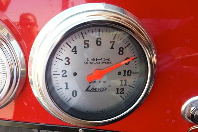

    Heres my 91 Lavey Sebring tunnel. I get about 90 with a few people and near full fuel in it.
    Its a blast to drive and can sustain top speed till the tanks run dry.
    I'm curious to see if anyone is actually running 100 on a pump gas small block.

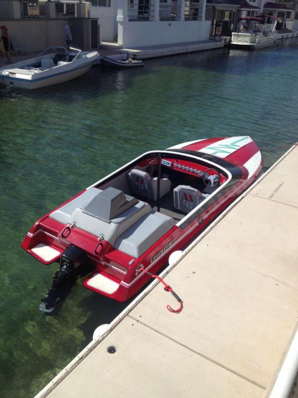

    Well.....just to be clear I don't see 100 with my boat.....82 or so in PERFECT conditions but I'm only running a 3.2L V6 at the enad of the day. The boat is a 92 Schiada River Tunnel with a 300xs hanging on a Stainless Marine bracket (no jackplate). It's a blast to drive actually and very, very stable!!

    Thats hauling coal- is that 82 with people on board or just you?
    UD
    The only time I saw 82 I was alone but had full fuel......~85 degrees and no wind!!

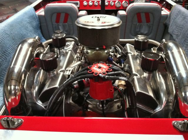

    That's impressive Uncle Dave. So what kind of regular guy parts are in that thing? Tell us all what heads and camshaft you're running and what king of RPM you spin to achieve that 89.

    400 GM iron block I had side bolted punched out a bit to clean it. Generic Steel crank, regular 5.7 rods
    forged Ross Pistons with zero gap secondary rings
    Brodix track 1 heads -2.08's, some hand porting (would be better to put it on a cnc machine)
    edelbrock single plane manifold (would probably run better with an air gap)
    demon 750/850 carb
    msd ignition
    engel custom hydraulic roller, with shortened overlap. (Ill dig up specs)
    Imco powerflow manifolds
    Dick Gazan picked and put the combo together. The guy on the right of the freedom machine. Cool old guy died a while ago it was a pleasure to know him. Alexi from boostpower tuned it and pulled the secondary water pump off and put a crossover in for me.
    I built the long block for 7500 bucks spend a few grand on the exhaust oil coolers valve covers etc..to keep it happy and alive- then beat it mercilessly from 98 to 2010 then refreshed it and tuned it back up.

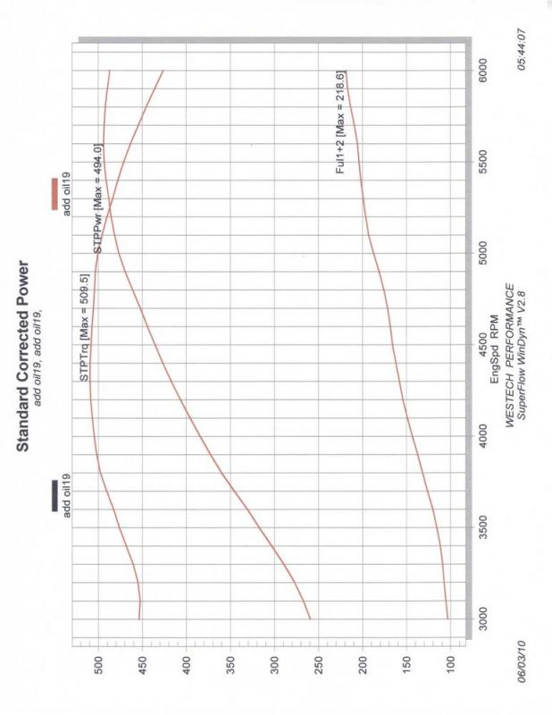

    Dick called it a 500/500 motor - Makes just under 500 hp/ and just over 500 lb ft with a curve as flat as kansas.
