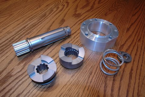

Not sure if whirl-away is a trademarked name or not... Here are the pieces (shown in the pic below) and, JERRY, keep me honest but at 4:20 in the video below when you shut off your HONCO in the video, isn't the sound we hear your PROP RELEASE in action???
^^^ THis is installed on the OUTPUT of the Vdrive and allows the ratchet/freewheel of the prop because the prop becomes a rudder basically WHEN an engine locks up/stops OR you get a lock up in your drive line for whatever reason, usually resulting in a QUICK out of control turn of the boat and the people getting pitched out...
I for the life of me cant remember who makes the parts in the pic that I posted, maybe BEAVERFAB??? Or you can purchase from Casalle... The spring keeps the two dogs engaged in the driven direction and allows the freewheeling of the prop if something locks the driveline...

I'm sure 7 can give us a very detailed history of prop releases. I know in the early days there was the Algon prop release which installs between the v-drive and the prop shaft. It was good but left a lot of room for improvement which probably explains why Casale got in the game with the Whirl-a-way. Many guys flipped their boats before these were a mainstay. Engine failure or a locked drivetrain turns your prop into a corkscrew shaped skeg without a releasing mechanism that allows your prop to freewheel..

The prop release pictured a few posts back is made by JJ Beaver of Beaverfab Inc. He also makes shafts, lockout handles and couplers among other parts. Both JJ and I buy sell and trade gears as well as rebuild v-drives for many peeps on the various forums.
