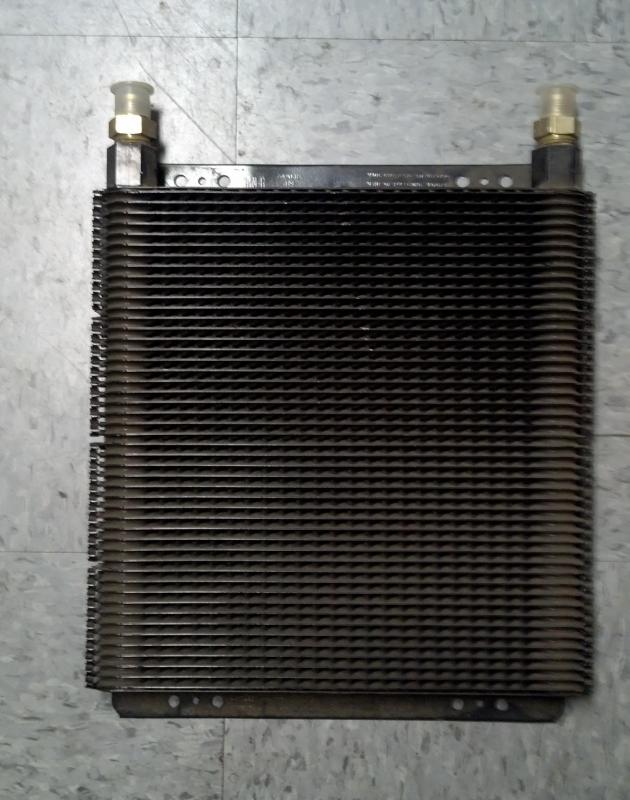

    Name:  Oil Cooler.jpg
    These are the oil coolers that I am planning on running. The engine oil cooler will get -10 lines. The effective cooling surface area is 8-1/2 inches by 11 inches. My transmission shop suggested -8 line for the trans cooler.
    The transmission has been upgraded with the good clutches, 5-planet planetary gear, and Corvette servos. Originally built and recently refreshed by Toy Shop Transmissions in Pomona, CA, along with the 4WD conversion. This combination ran and towed great in the ‘burb that I pulled it out of. Again, I would just like to maximize my combination. Any and all suggestions are greatly appreciated.
