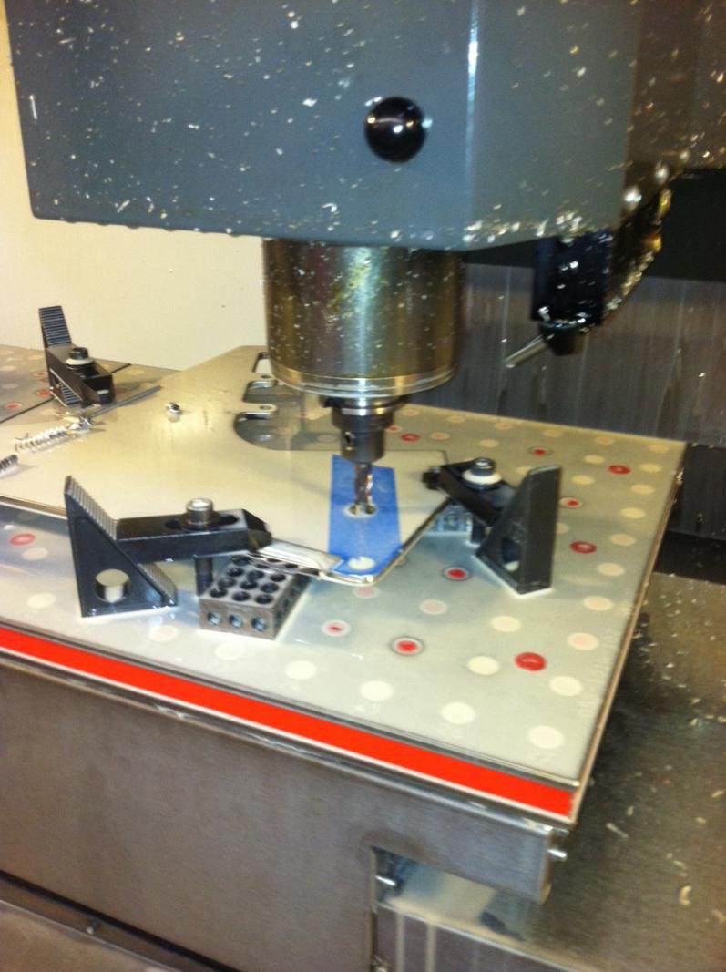

We commissioned a part to be machined and installed in the water dump. We then had the wing plates CNC and chamfered to pass the hose dump through. I am happy to report this has cured all water reversion issues on our boat. The engines are untouched and factory stock in configuration. When the dump water is routed below the wing plate the water reversion is eliminated as there is no water in close proximity to the intake or rear portion of the cowling.

If you are interested in a set for your boat please contact me via PM or E-Mail. I can also have your wing plates CNC'd and chamfered if necessary (See photo below). In the alternative you can do them yourself it is not difficult. Once I know how many units to make I will provide you with a final cost. Obviously the more units we make the lower the cost and if you want us to CNC the holes in the wing plates it becomes more involved. As of right now I just want a determination of how many units to produce.
