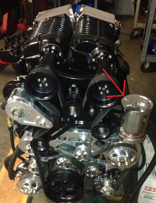

What is the clear (filter?) hooked to? At first I thought it was a Clear View oil filter, but I see its different.

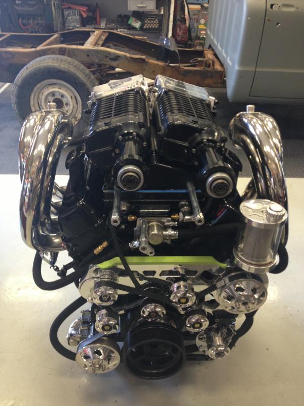

1025 detuned correct? 540 block? Who's heads, AFR? How much boost and what octane, 91?
And whats this??
It is a 572ci Merlin tall deck, Grumpy Jenkins heads running 9-10lbs of boost on 91 octane. I will put some AFR heads on her in the future and bump up the boost to get 1100+ HP if I want more power but as it sits with a really fat tune I am cruising 70-72mph, 3800 rpms at 21% throttle... :-).
The clear canister is my power steering filter. I am running the Hardin Marine billet serpentine system on her.

The whole front pulley, power steering pump, alternator, and sea pump are all on a billet bracket that comes off in one piece. No alignment problems with the accessories, just had to make a .125 spacer for the crank pulley for the blowers. It is pretty bad ass!
