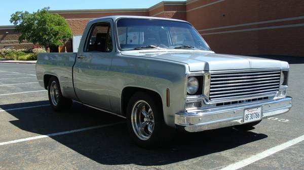

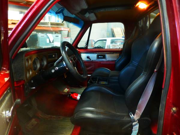

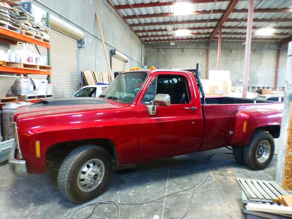

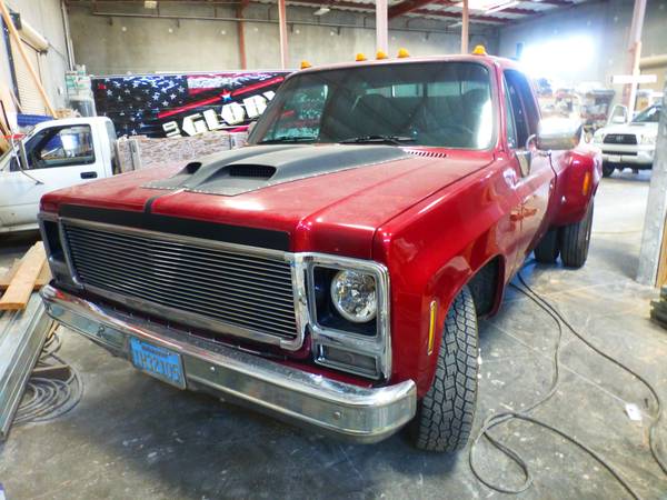

    No thanks, but I may ask you to go check out another truck for me in Sacramento. I've found two to add to the collection.
    This one for play:

    This one for towing:
