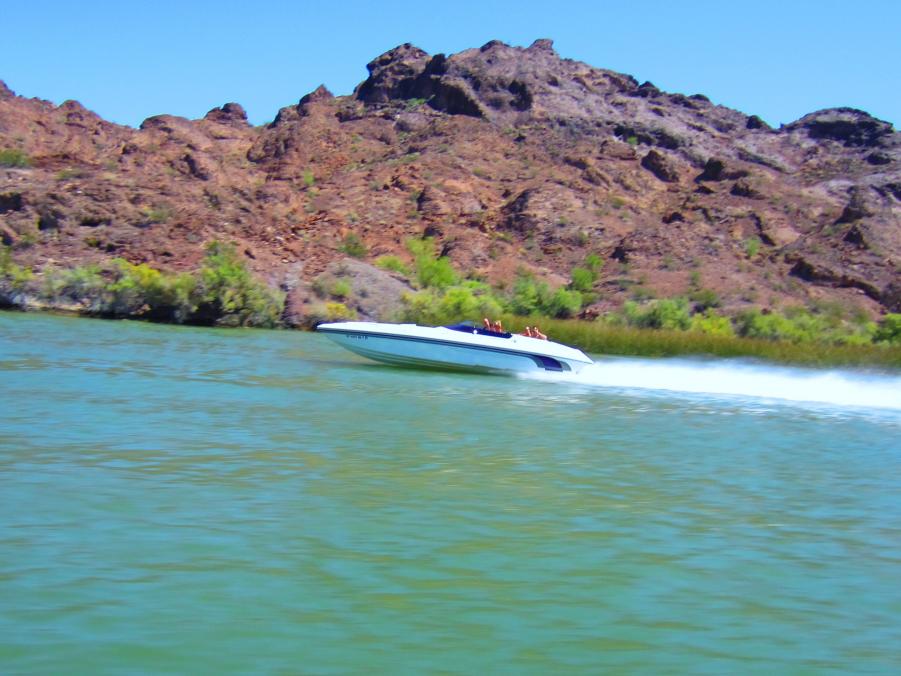

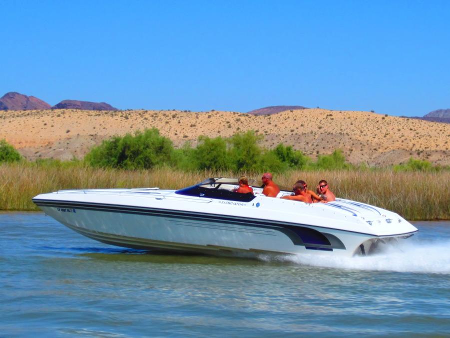

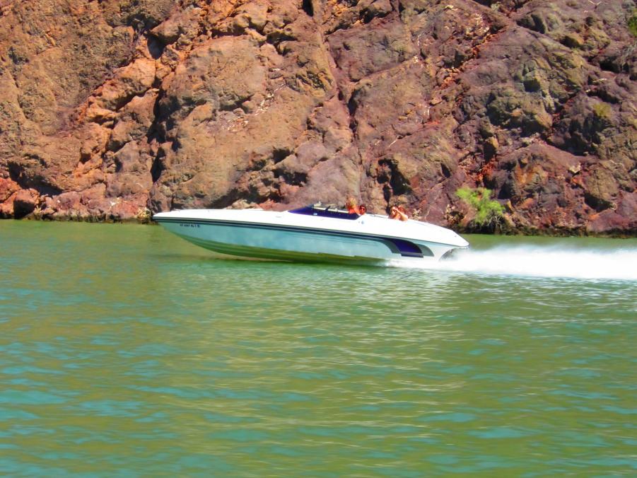

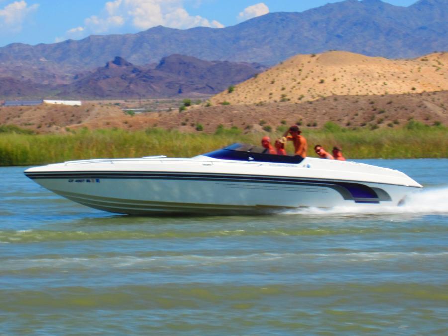

    I dinged up my good prop a couple weeks ago (yeah I know).... Now I need to get it fixed. I had Cutting Edge do some work to it 2 years ago. Cut most of the diffuser off, and tweaked it. I told him I wanted a couple hundred more RPM's and it gave me about 100... I'm guessing.
    The prop is a 28 Mach, which they apparently don't make any more. The boat has always run wet, I can't trim it enough to get the Bow out of the water
    I'm thinking I want the rest of the diffuser cut off at least.. Thoughts?

    The last pic has it carrying a little bow.
    I'm sure you tried Bravo 1's? If not it should be easy to borrow some.
    Kalifornia
    2,088
    I have a 26 Bravo for it.. It hates it. Buries the nose, and is 5 or 6 MPH slower, and blows out when planning. I keep it for an emergency spare.
