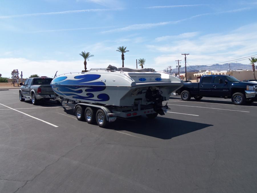

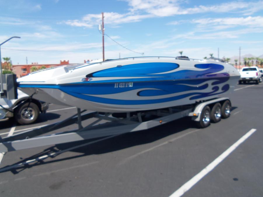

    here's her old boat.... sure a few of you have seen it on the river and at havasu......Name:  100_1168.jpg
Size:  53.9 KBName:  100_1173.jpg

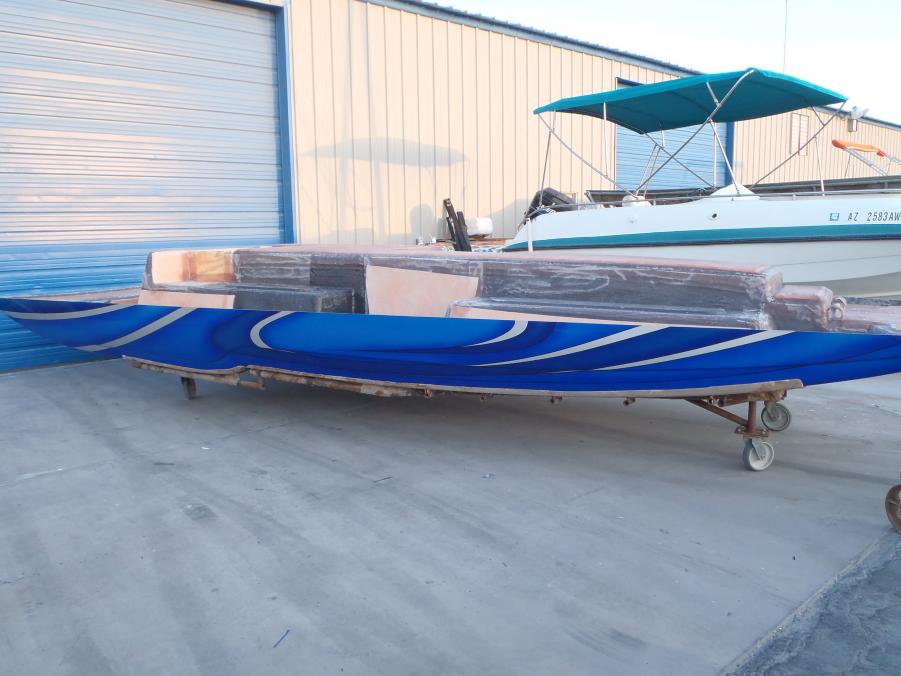

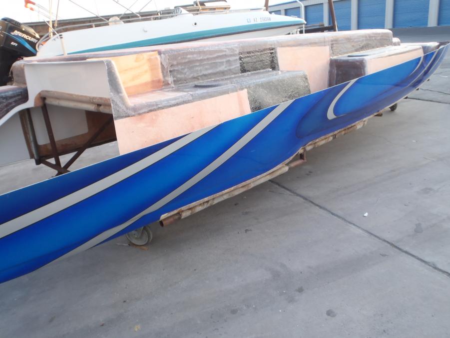

    Ok, on with the build,
    If any of you have ever delt with Cheetah bob, what a treat....no pressure kinda guy,, if you want it fine , if you don't ... well that's fine too
    so now the build starts... very first thing , you have to decide on colors, and grafix on the hull..
    this is were it get skechy..you have no idea what it's gonna look like till it comes out of the mold, and guess what....
    yep....YOU OWN IT!!,,..
    so when ever you see a boat that's bad ass, or horrible, that isn't production made copy.... keep in mind what the owner had to go through

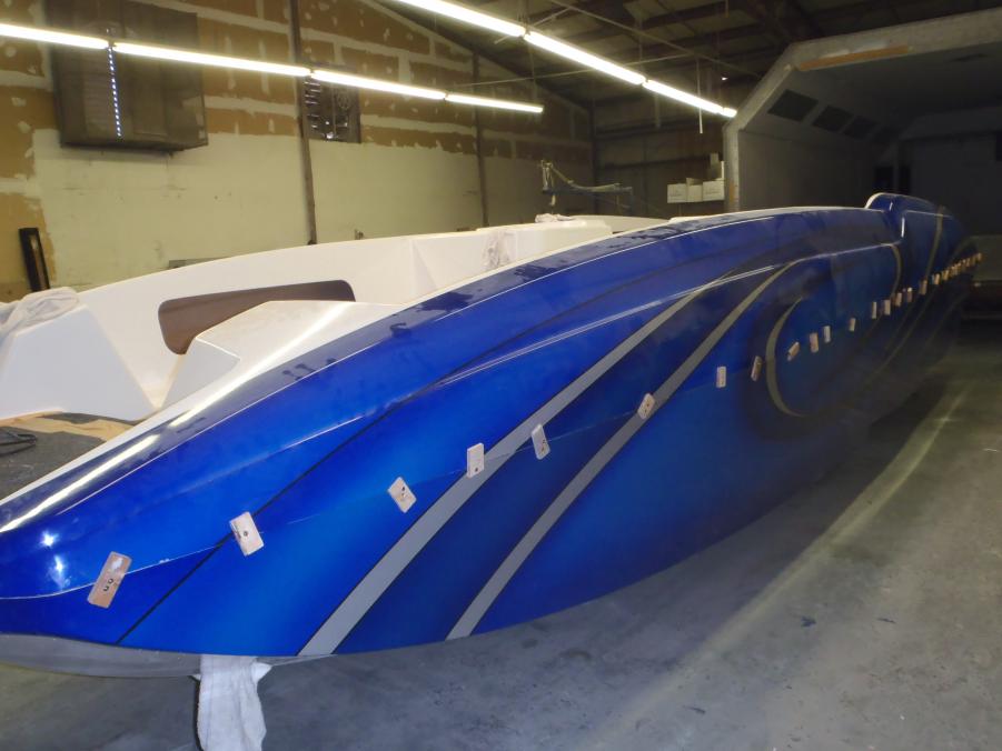

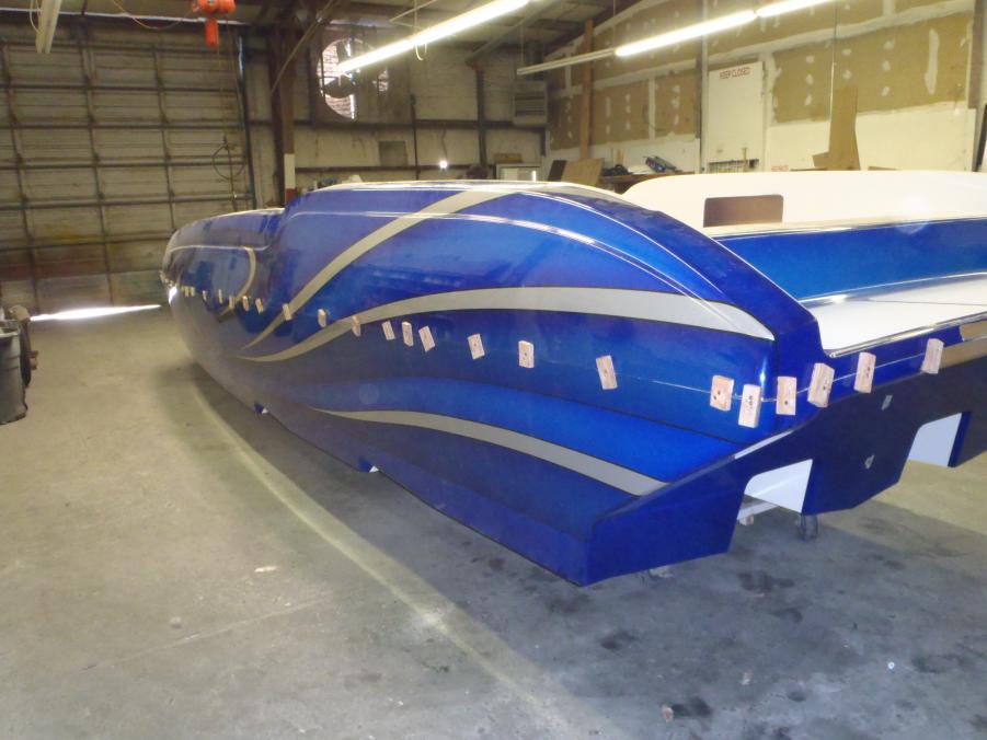

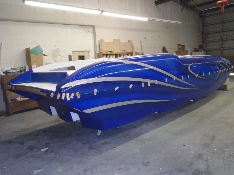

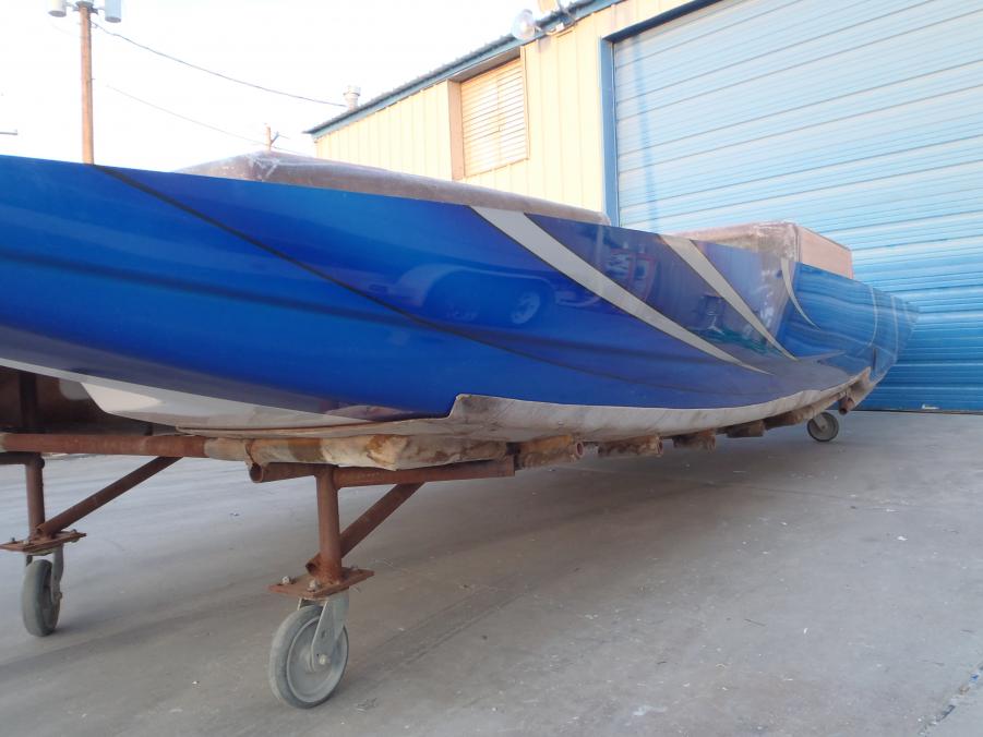

    so after about a mo. of waiting... they finally popped it out of the moldName:  cheetah havi lot 001.jpg
Size:  71.6 KBName:  cheetah havi lot 002.jpg
Size:  77.9 KBName:  cheetah havi lot 003.jpg
Size:  74.1 KBName:  cheetah havi lot 004.jpg
Size:  59.1 KBName:  cheetah havi lot 005.jpg
Size:  66.4 KBName:  cheetah havi lot 009.jpg

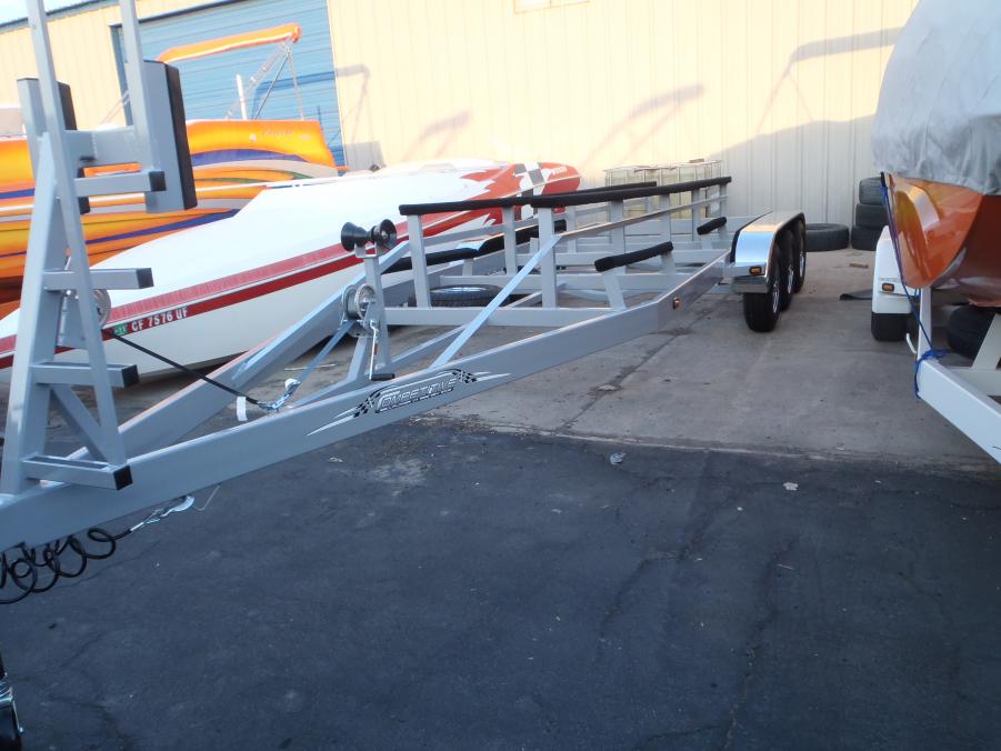

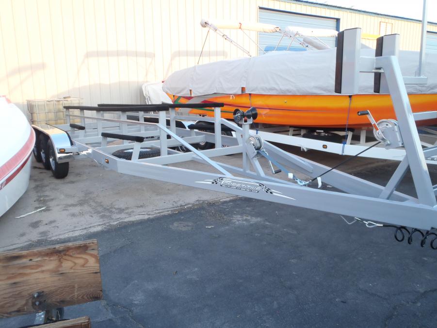

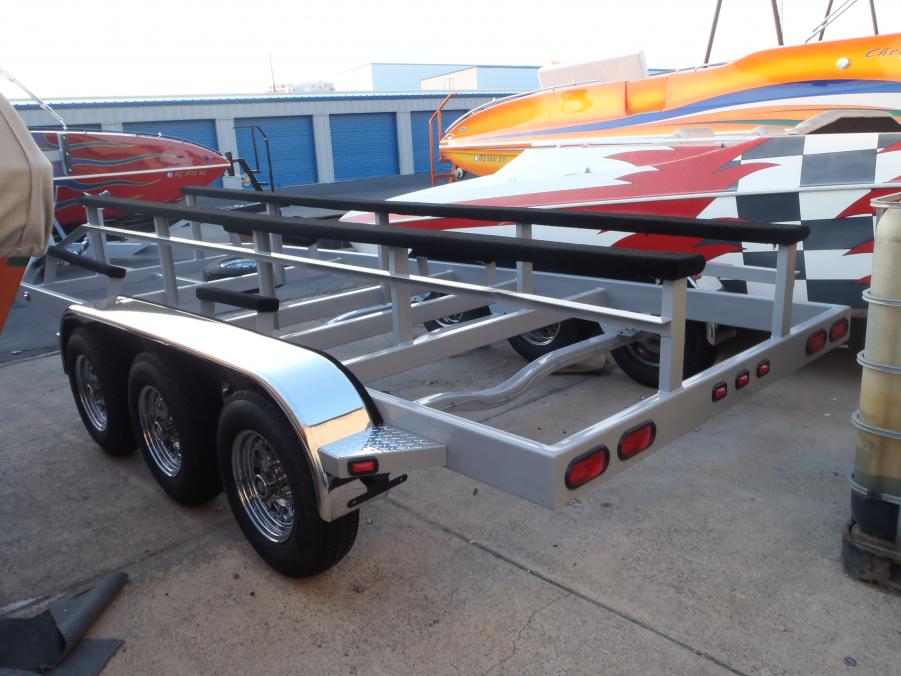

    Now we need a new trailer, with the stock option, you get a painted fender tandum axel trailer trailer...
    the trailer is a 7000 lb gross weight..... well, by the time you add fuel and gear it just too close for comfort for me
    so for a couple grand more we setted with a triple axel, stainless fender trailer
    Name:  cheetah havi lot 006.jpg
Size:  71.4 KBName:  cheetah havi lot 007.jpg
Size:  76.2 KBName:  cheetah havi lot 008.jpg

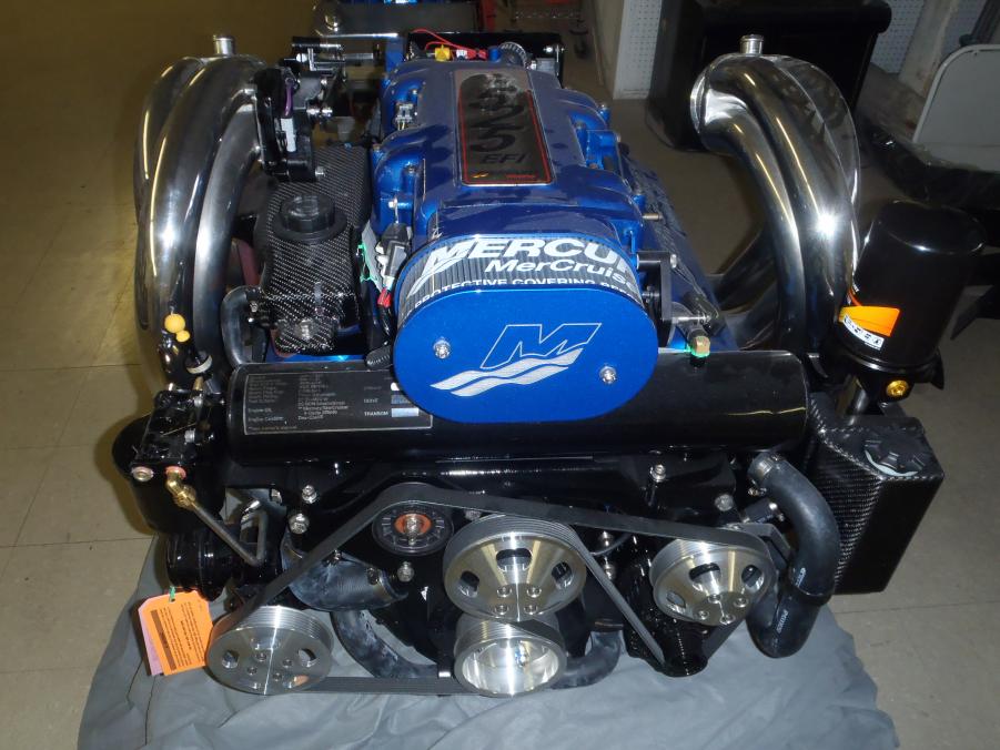

    so now we have hull, well, two halfs of a hull on dollys... and a triple axel trailer..
    we also up graded to the 525 power package and full hydraulic to the helm steering....

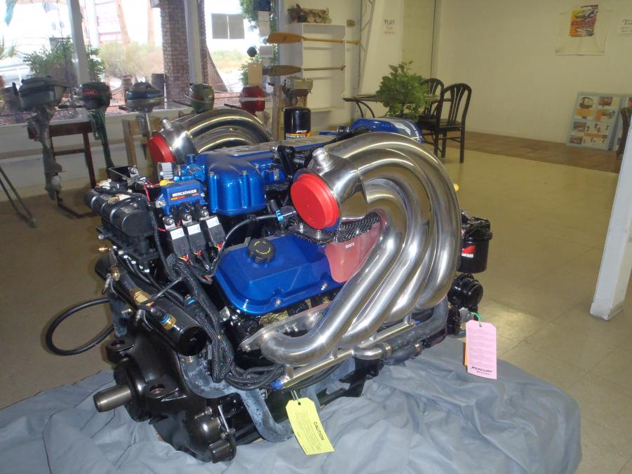

    we ordered the whole sterndrive package from merc, I believe it comes with an xr drive
    all kinds of storys from every one on what they think the boat will do speed wise with the 525 power,
    but I'm gonna start with what NODIGG on the boards said be cause he had one with the 525 power....
    he said GPS'd 92 mph gps'd
    we will be happy to be able to cruise 70 with out having to be on pin and trimmed to the moon
    the power package arivedName:  tahoe,suesboat,househallett 068.jpg
Size:  88.0 KBName:  tahoe,suesboat,househallett 069.jpg

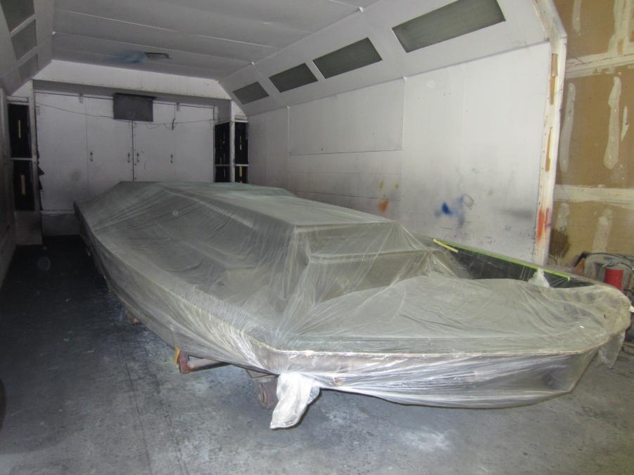

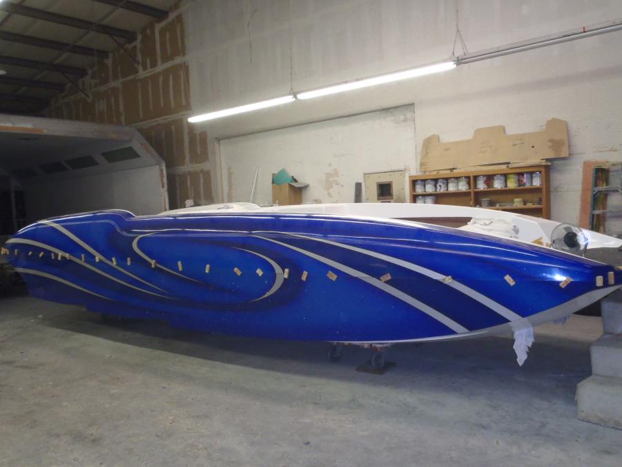

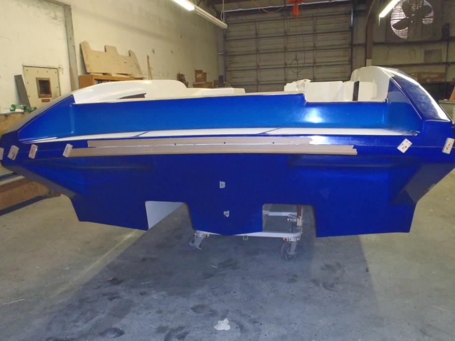

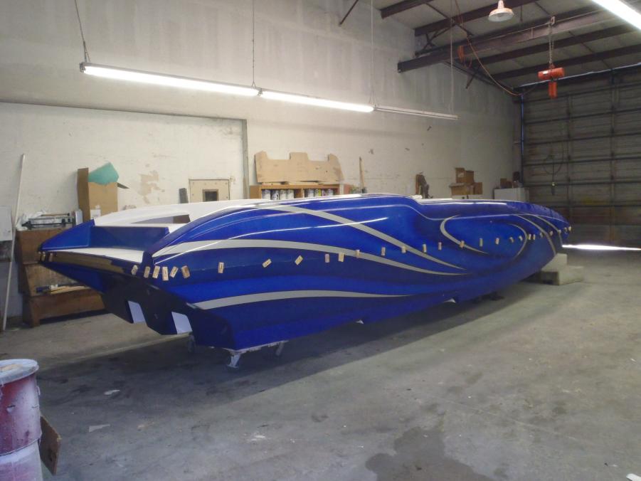

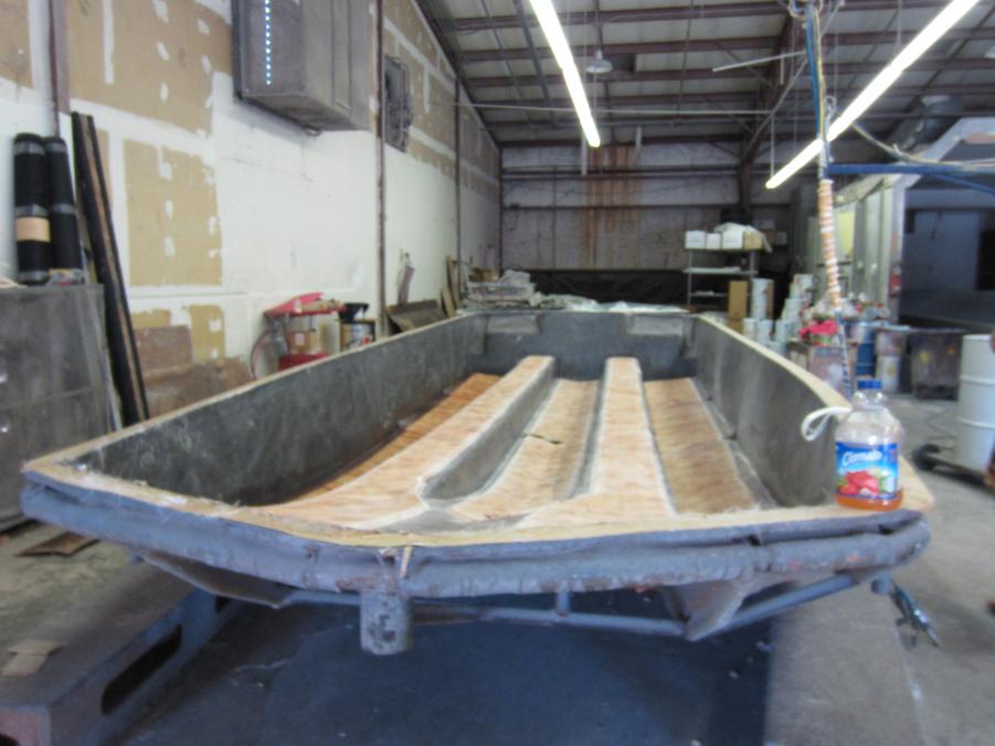

    the actual hull build is a lengthy process with little to show for progress,
    the two half are prepped , there are (I think), two types of hulls,... a clam shell(top and bottom mate together) and
    a "shoe box".. top over laps....this is a clam shell...
    another wait and see deal here..... you have to hope the grafix line up
    how they even get close is a mistery to me, you have to tape inside out and backwards...

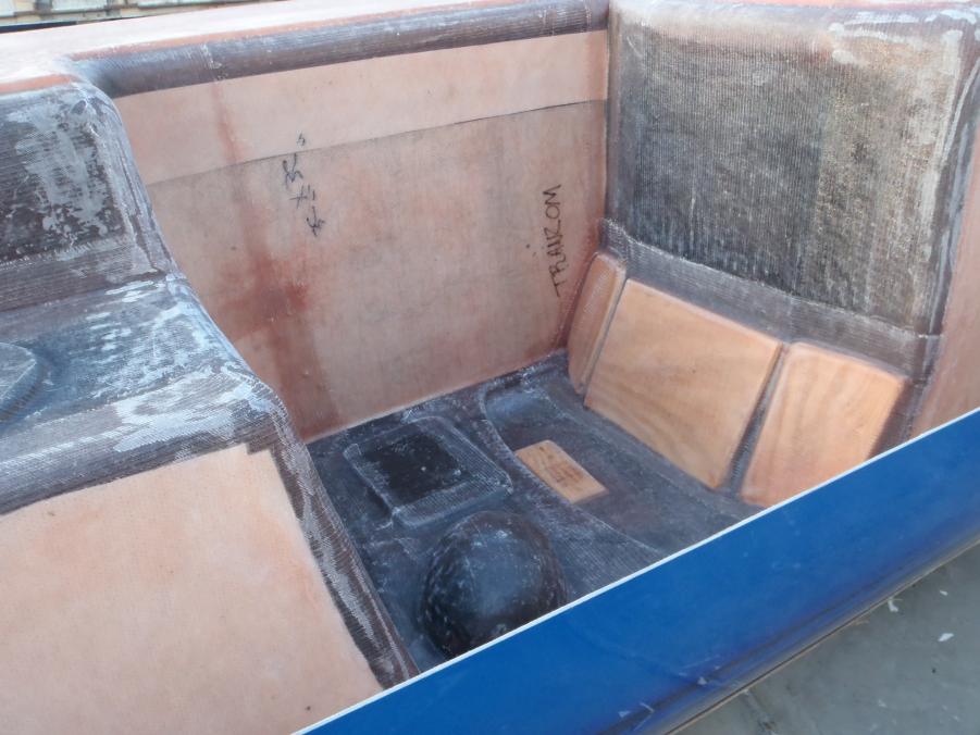

    while the halfs are apart, all the bulk heads and balsa core is installed, this boat has a 90 gal belly tank and it must also be in stalledName:  baja boat lot 014.jpg
Size:  65.8 KBName:  baja boat lot 015.jpg

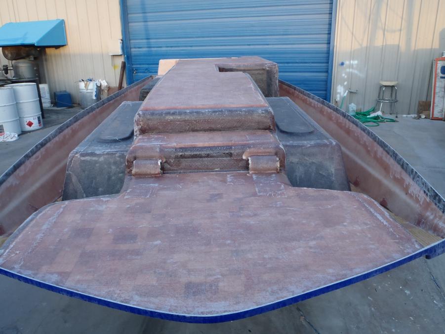

    Once the two halves are prepped, tank and bulkheads are in stalled,... they bond the two halves together,
    these boats have a full fiberglass inner liner , way better IMO than plywood floors... the top bonds to the bottom way better making a very solid hull...
    after 4 years of pounding havasu in the old one... not one crack anywhereName:  sues cheetah 001.jpg
