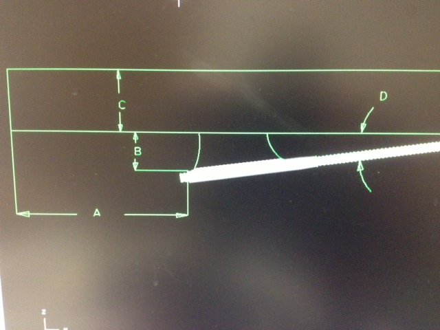

Micheal, when you get closer to putting this back together would you like me to make you something like the pic. I'll make a generic drawing, you plug it the numbers and I'll redraw it with your numbers. It might give you a better understanding if you are looking at it on paper. There are a lot more dimensions needed than the pic, that's just an example. Then you and Joe can go over it together and make adjustments where you need them.
Attachment 35564
yes ill get you the dimensions i have and well go from there thank you
