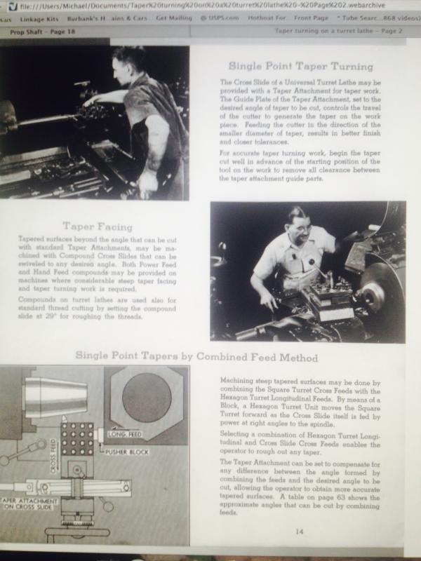

so i asked Glenwood to send me a picture of how they cut the taper on there prop shafts ...what i got back is this please follow along
Hello there Thanks for inquiring about our prop shafts , i will try to answer your question, we used this set up for many years see attached photo
than in the last ten years we upgraded to the modern set up in the next photo Hope this answers your questions
Regards Vicky
notice the date on the brochure 1944

didn't miss anything i agree the operator of the machine is where it begins , but i also do know that a process used 50 years ago was fine 50 years ago but times have changed and motors have changed since 1944 and materials have changed and more exotics available today than in 1944, i do remember you saying to machine this material you need a constant surface to cutter speed at all times so it must be done on a cnc machine.
the tool used at the other shop is nothing more than a pencil sharpener basically, i can not see the same quality coming off the two different machines . in fact my old shaft from the old supplier has chatter marks on the taper running length wise from the pencil sharpener tooling thats being used

#138
SFM is ultra critical for these material, yes I did tell you and everyone that, and it is. If you can find a supplier that has the equipment to maintain that constant SFM that's where I would be going.
However if somebody is dead set on going to someone that only has conventional turning capabilities then the SFM on the taper needs to be run to the largest diameter. Also in my opinion that box tool in the pics you put up is absolutely the worst way to cut a taper because of the heat it generates, a taper attachment with a single point tool and a large radius would be the way to go. And only removing .010 -.015 a side max per pass.
i agree and the pencil sharpener tool was a upgrade 10 years ago! its what they use today.

A box tool is completely acceptable for materials that don't work harden easily.
its what is used on Kmonel and Aquamet 19, they don't sell 22
