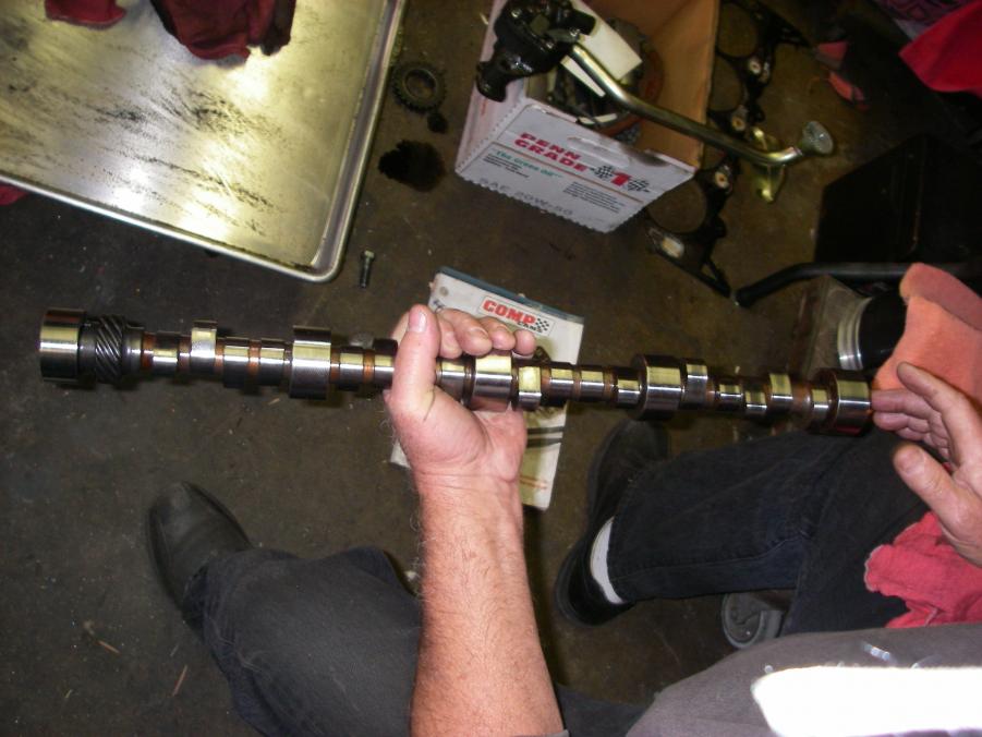

    Anyone have a clue who's cam Greg was running? Jeremie said he thought it was a Chris Straub grind but I e-mailed Chris and he said that it wasn't his.
    It's 00K2A 139456. I was thinking it might be a Crane Cam.
    Look at the end of the cam, if it's crane it should say crane. The 13 indicates that it's for BBC, 945 will be the type of cam/grind it is. The copper paint or die between the lobes also looks like a crane. Call crane they'll tell you exactly what it is. With a number like that it's not a custom grind it's a catalog piece.

    We looked at it pretty good. I don't think it's the original cam just a new grid of the original cam.
    edit: You can identify a genuine Crane cam core by the distinctive copper plating between the lobes.
    Is it a solid or hydraulic roller?
    I run a hydraulic roller crane PN 139651. The number on yours is close.

    It's a solid roller.
