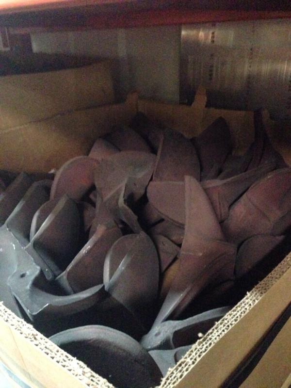

Grose props don't have welded ears. They are from a forging. Maybe I'm missing something but that's straight from Joey and Ron grose's mouth. I spent a week down there with Scarlata and saw the box of forgings.

Sorry but GN7 is WRONG on the welded ear portion about Grose props! Forged one piece props are far stronger than a prop that has welded ears. I'm not saying a Grose prop has never cracked, but it's proven to be stronger than the standard Radiance or menkins.
