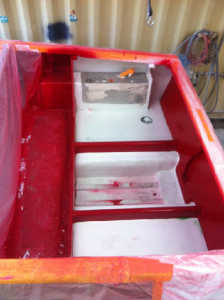

I did not take nearly enough pictures of the fiberglass stage. The bilge was sanded smooth and all the holes were filled. The exhaust was filled and moved up about 8 inches. The dash was filled and re sprayed and the entire boat was color sanded and buffed.
I don't have any good pictures of the dash or outside of the boat but this picture shows the transom with all the old holes filled in.
