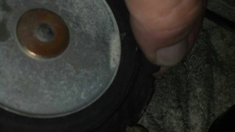

    Buwahahaha...Hole in the diaphragm.
    Sent from my hemDROID
    Re: Fuel delivery
    I was gonna say yes, its possible, but it looks like you found the problem. Good job!

    I haven't found the problem until its replaced and I'm rolling out tomorrow with a motor that runs. But a hole in the main....I'm hoping I'm closer to a resolution.

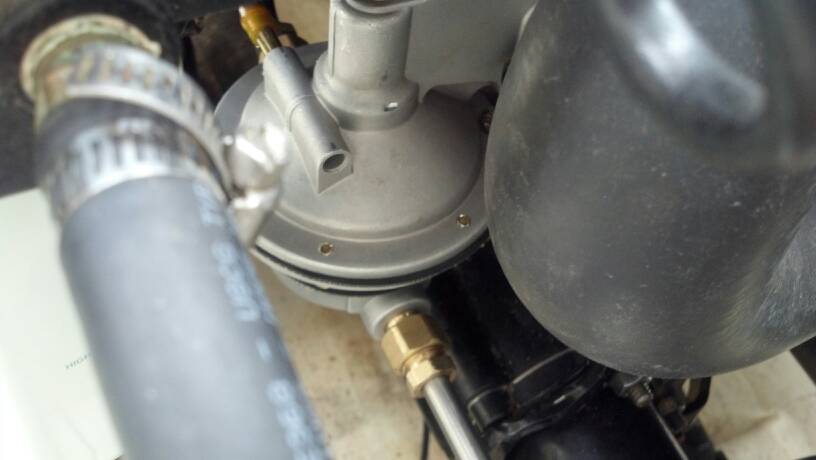

    Jackpot.
    OK....I physically visited west marine 5 times yesterday since they were pretty much the only place open. No biggie....they're 3 minutes away but they still pretty much suck.
    Today, I physically went all over havasu.....Prestige, OCM, Alco, absolute, Al's, lakeland, jacks, auto zone....this pump is officially big foot. They know of it but haven't seen one around or don't stock it. Alas....west marine. One on the shelf. Purring again.
