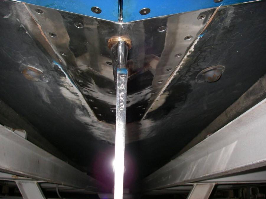

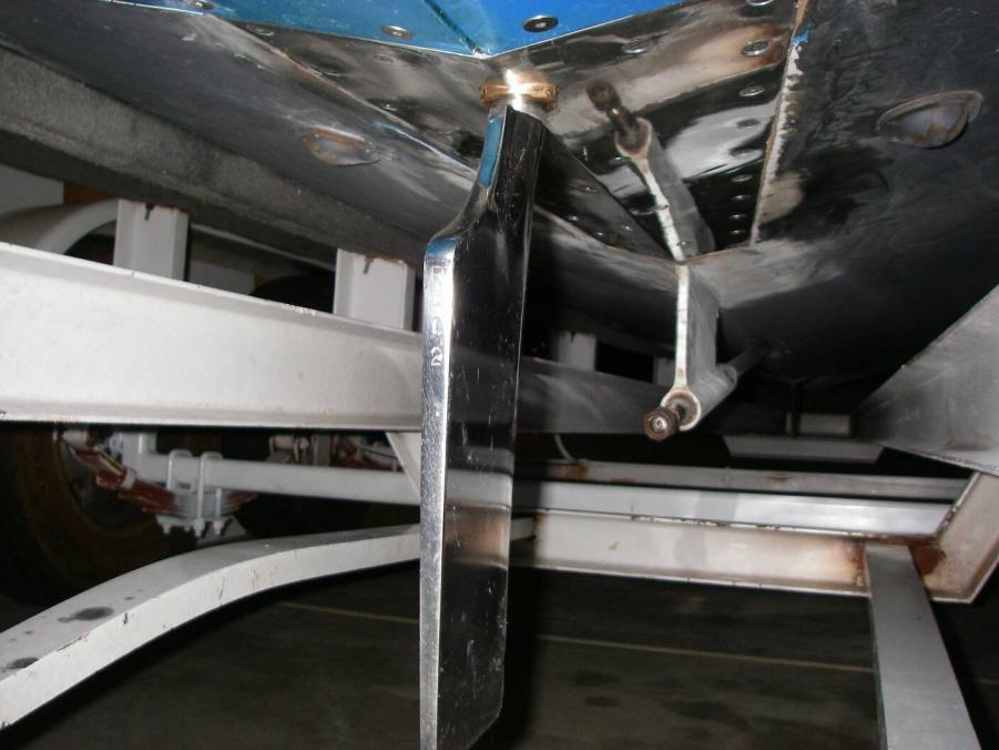

When I got the boat home I measured the following: The strut angle is 7.8* with a 6" drop. The distance between the transom and strut is 25". The cavitation plates are 9.5" from the transom and end 7.25" from gunnels. The distance between the engine and transom is 20". The centerline of the gearbox is 100" from the transom, 4" from the bulk head and about 15" from the deck/dash.
I also did a little research via the boards and thru his close river friends Jeremie and Tom.
Jim Lange (High Tech Marine) re-rigged the boat and rebuilt the engine around 2008.
I sent Jim a PM and this is the information he gave me. The strut was replaced with a fabricated steel drop thru and strut braces, new rails and mounts, relocated V-drive replacing the original Champion V drive with a rebuilt Casale split case, new A22 prop shaft, new Menkens prop, installed new "adjustable" cav plates (originally had NO plates). I never drove it, but from what I've been told, it handles well. The transmission was built by a guy that used to work for Art Carr. I believe it has a Crower crank, Manley rods and JE pistons. All new Manley Severe Duty valves, new oil pump, rings and bearings.
