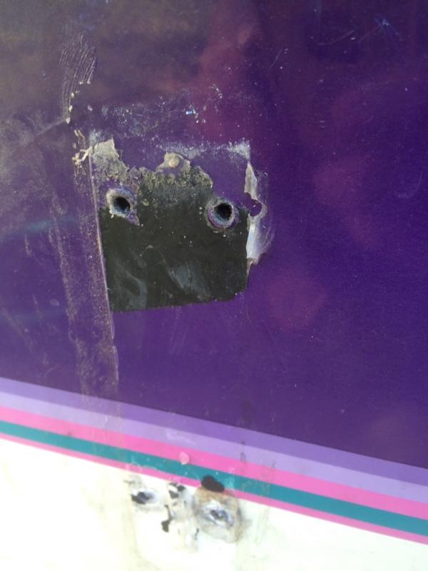

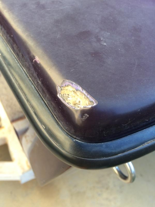

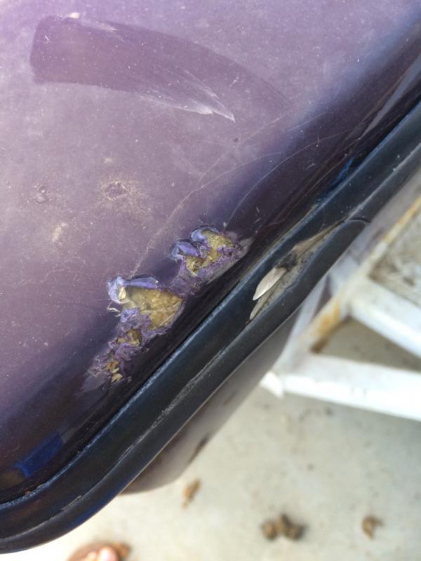

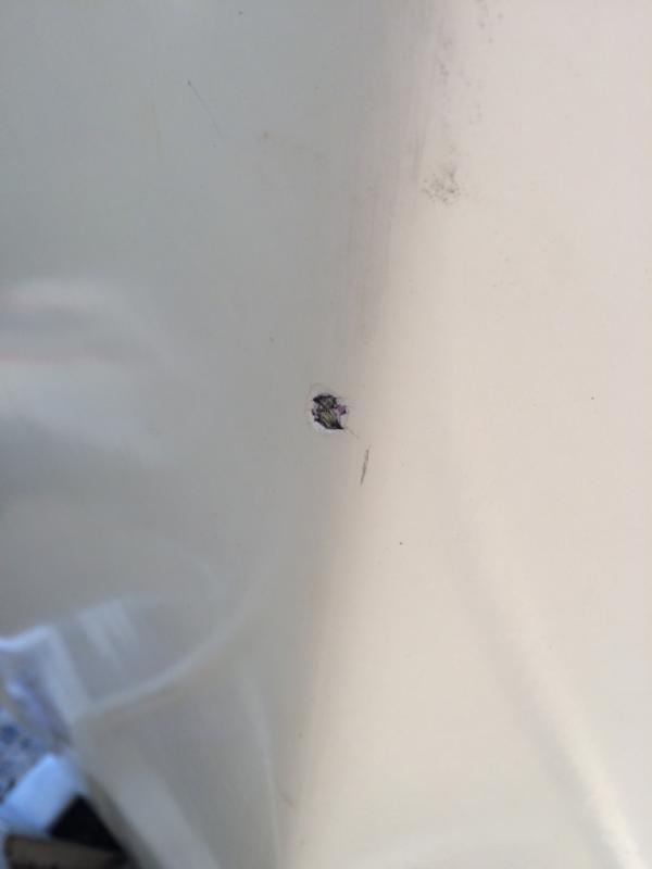

    Ok, so I'm thinking I'm going to polish it myself since it's only for a couple years.
    However, there are a couple places I think I need some gel work. 1 on each side as well as a couple on the bottom of the boat. In addition I'm going to need some holes filled where my old swim step used to be.
    Does this look like a big project to have done professionally?
    What can I expect to spend fixing these minor issues?

    Here are holes that need to be fixed from the swim step brackets

    The purple is going to be tough to match with the gel in that condition. I would try to revive an area of the purple and then wait about a week to see if it's going to "chalk back over". If it goes foggy again, then the gel is dead and you won't be able to clean it up. If it stays shiny and clear, then you can look into the repair. Just from your pics and previous quotes from my fiberglass guy, you are looking at about $1500-$1700. Hope that helps!
