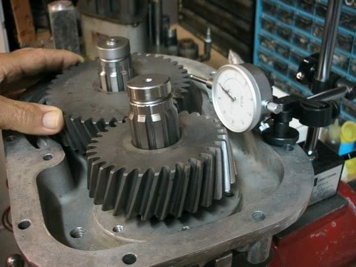

according to andy at casale 29 is all you can get , before you remove the water jacket he rebuilt mine when i did the motor and that was the max gear before it hits the case
if i cut the case it will run to hot on a river lake boat
see the 29s almost touch the water jacket
