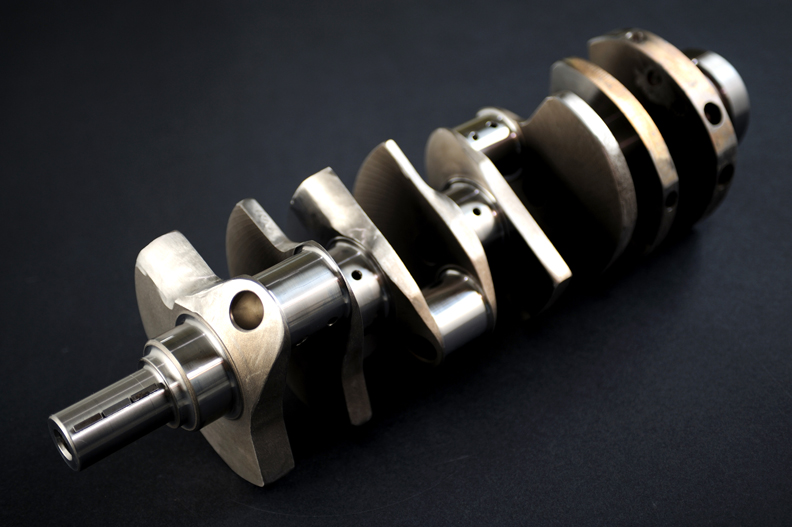

Once I learned what was being used in the 1350/1650 twin cam engine, it pretty much told you whats NOT in the 565 or 600, let alone the 520 and 540.
This is the crank in the 1350/1650. I assure you, its NOT a Sonny Bryant or Winberg.
I am almost certain it is a Lunati. Its most likely a "Pro" but Merc's replacement cost is $6000.00 A Lunati Pro crank is about 1700.00
A Sonny Bryant EN30B billet is less than 4000.00 LIST!! and nobody pays list!!
The rods are even worse, in that I'am pretty sure they are Lunati H beam IMPORT rods!!!
The pistons are 476 apiece, head gasket is 373 EA, and these are the "online discount" prices.
For 6000 this should look like jewelry.
This is a Sonny Bryant billet.
ANY QUESTIONS?
