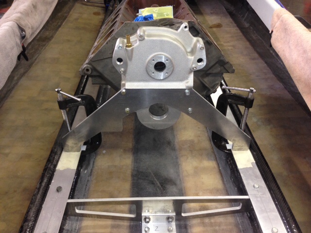

After the epoxy cured I started finish sanding in preparation for flow coating, I decided that I should start fabbing the new hardware before the final flow coat so I wouldn't have to worry about scratching it.
Attachment 40484Attachment 40485[ATTACH=CONFIG]
As you can see, everything is going to be new.

Looking good! How much of a runner is under your boat? Is it the normal 5/8ths? Looks shallow in that last pic...
What color are you thinking for the hardware?
It's actually the smaller 3/8" runner, it is a great boat to drive and takes a nice set.

Thank you. The engine is 525ci, pump gas, 10:1 compression. Ford Super Cobra Jet aluminum heads with a quick fuel 1050 carb. I had it in my 96 Mustang last year that went 9.82 at 139 foot braking so it makes decent power (about 630), I want to try a little bigger cam and a different intake for the boat to see if it will make a little more power. Really hope to run 10 ohs on pump gas, we'll see?

That's interesting. I've never seen a 3/8th runner with anything but a straight deck much less the bubble T aka GT deck.

Now that you mention it, I have never seen another GT Hondo with the smaller runner bottom. Every other GT deck I've ever seen had the deeper 5/8" runner. Thanks for the video, that Cole hauls the mail!
