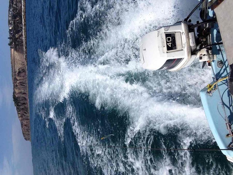

    Here's the only picture I have of it at the moment....not sure if it helps.
    Sent from my Kyocera.
  3. #13
    You have bigger problems than just the alarm. It looks like your whole world has gone sideways.
  4. #14
    Quote Originally Posted by Menace Marine View Post
    Its the new Pacific Intercoastal Vertical Waterway. Its a bitch to get on, but once you're on its a helluva ride
