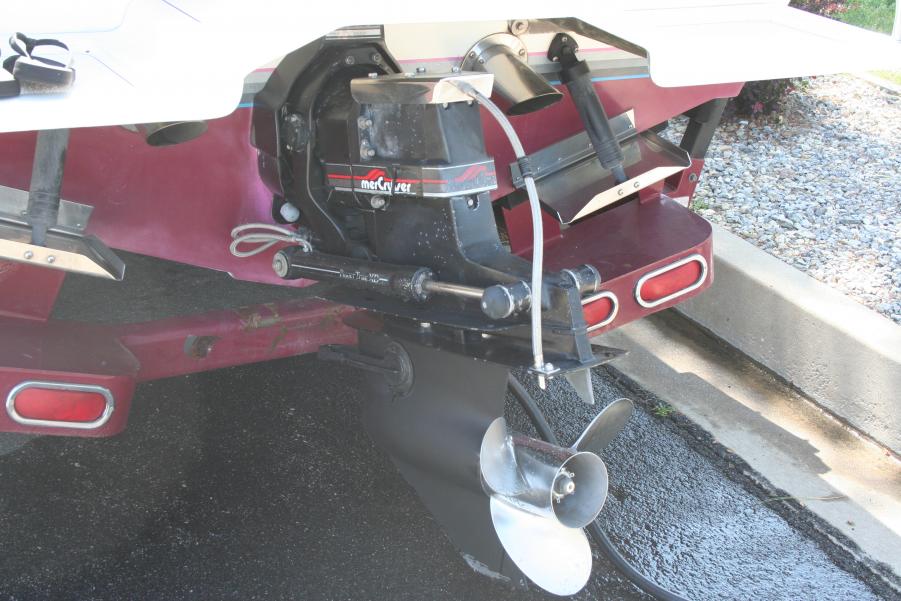

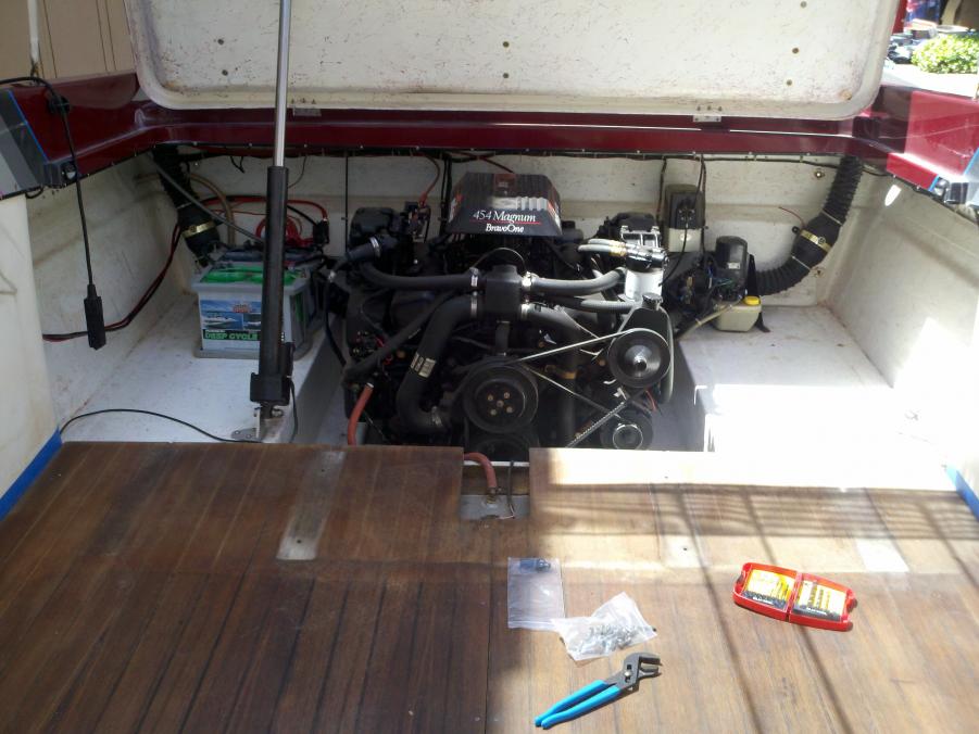

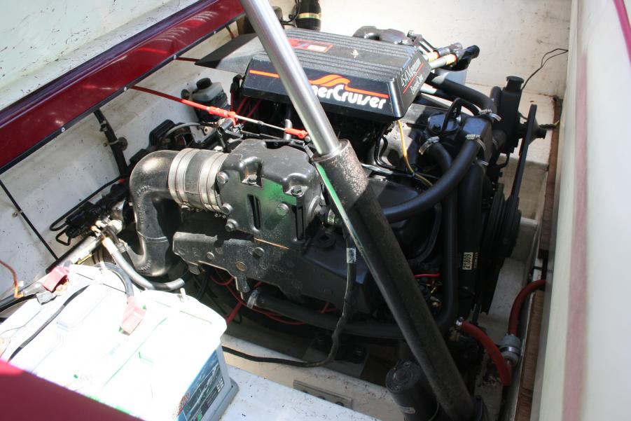

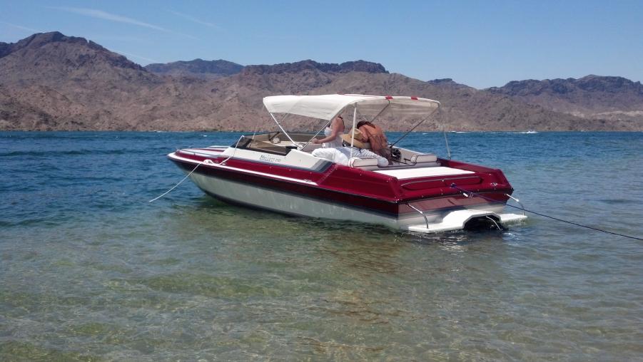

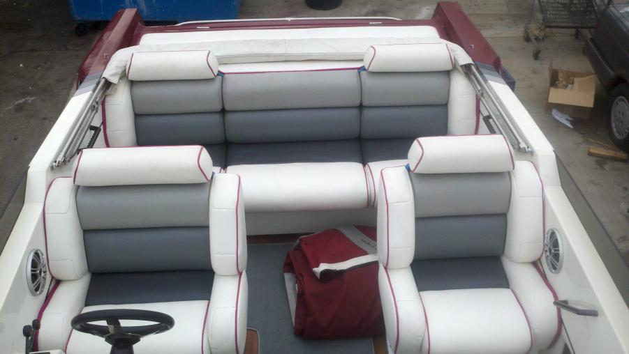

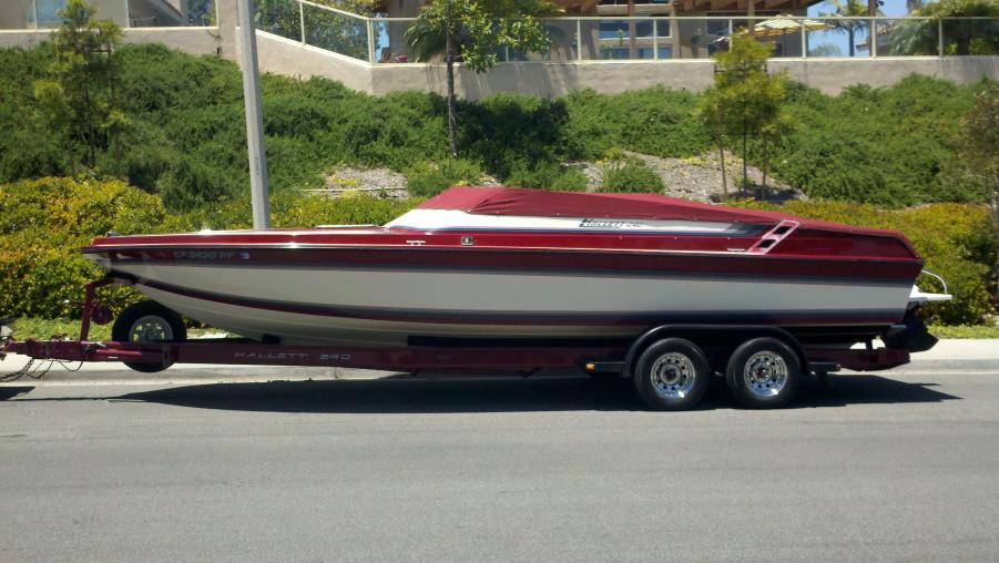

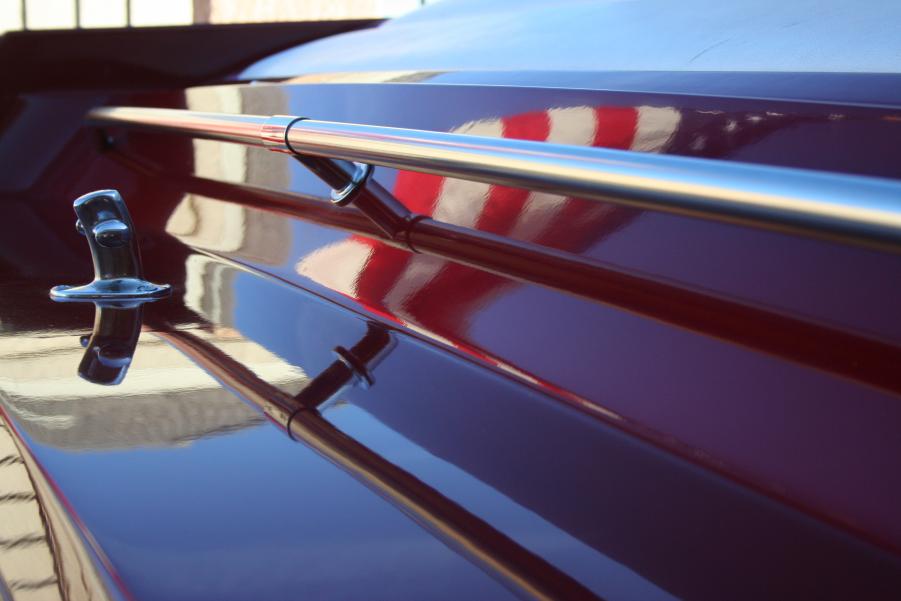

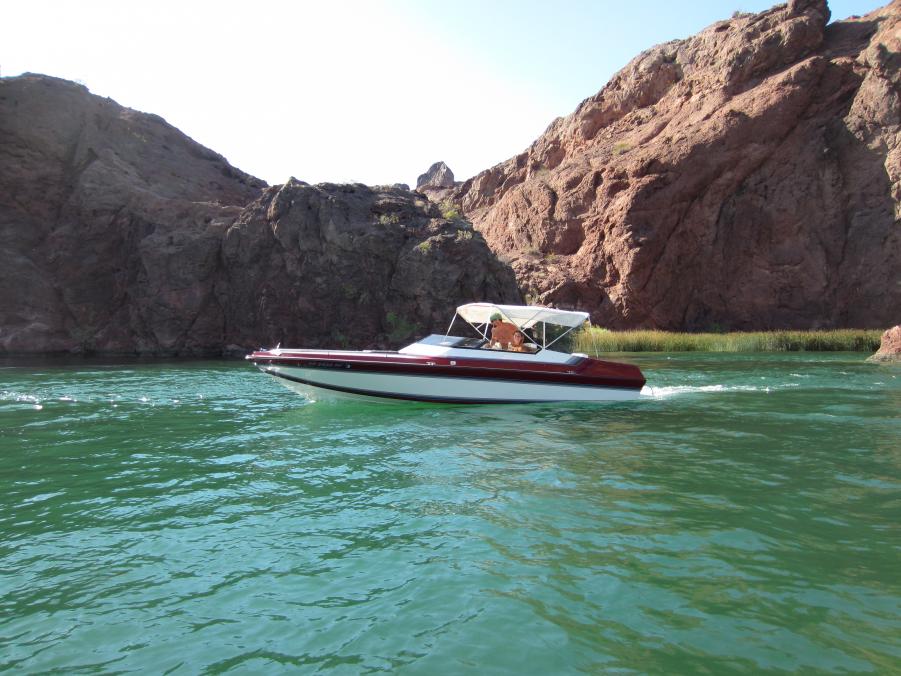

    Here we have a glorious 1990 Hallett 240.
    I'll list a few features that might not immediately jump out at you...
    -Era Specific gel with timeless cracks and plenty of dock rash to be seen at any angle
    -Original Interior....pure sex IMO
    -Frankenstein trailer complete with murdered fenders
    -Merc 454/B1 with through "straight out of badass" hull exhaust
    If that wasn't enough I have no clue what the hours are but based on previous owners experiences I'd say around 500....gonna go till she blows.
