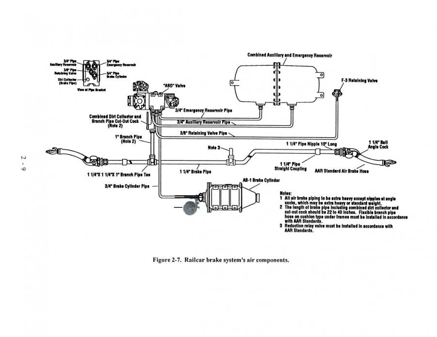

Well, yes and no. Main air pressure for the main pipe on freight is 90psi, on passenger it's 110...main reservoir pressure is 125-140psi. I do not need dynamics to stop a train, I can do it with stretch braking, and maybe a small shot at the end. All engines, every one of them, has a compressor and a it's engaged at all times. Some are shaft driven, others are electrical, and computer driven. Depends on the the model and the year built. I have no control over them, they do as they please. As for the cars, each has a tank, and that is always charged 90psi. It is the ABSENSE of air, that sets the brakes....as in this diagram...

I took down the other pic because I didn't catch that. 60 pounds is from the old days....we run everything through the pipe at 90psi....as for riding with me...it's not worth it...you would have to get to BFD, ride up, then ride back down the next day in the cabcar....too much work for a view that to tell you the truth, aint that great....
