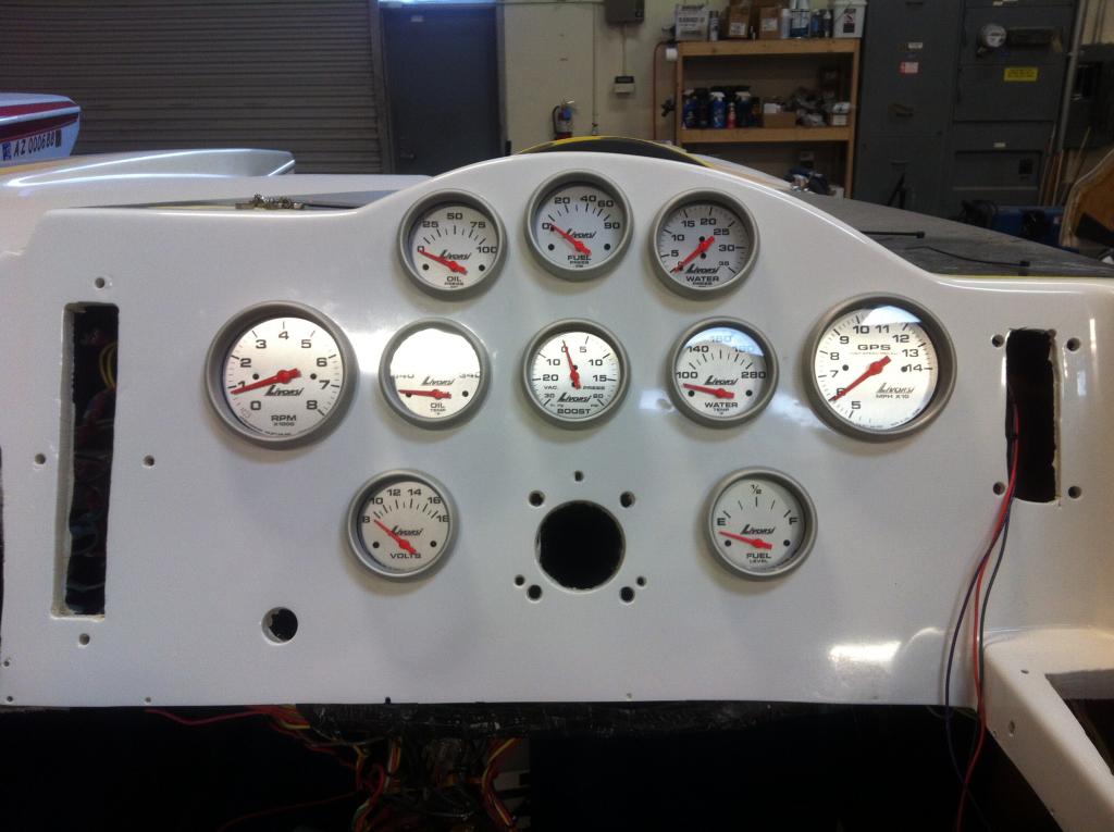

Gauges are in and wired. Waiting for new controls and some anodized parts.

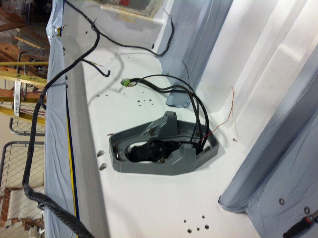

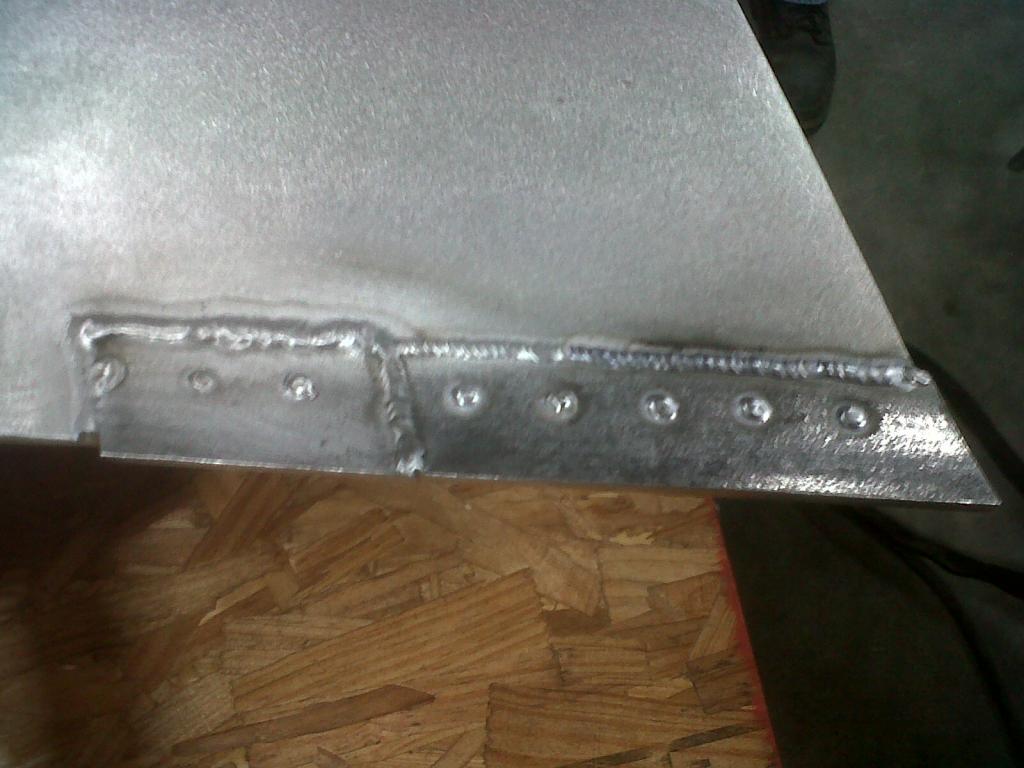

Gimbal is back on the boat with the new imco inner transom plate. And water pickups are installed and trimmed in the sponsons.
Going to mock up motor mounts tomorrow.
