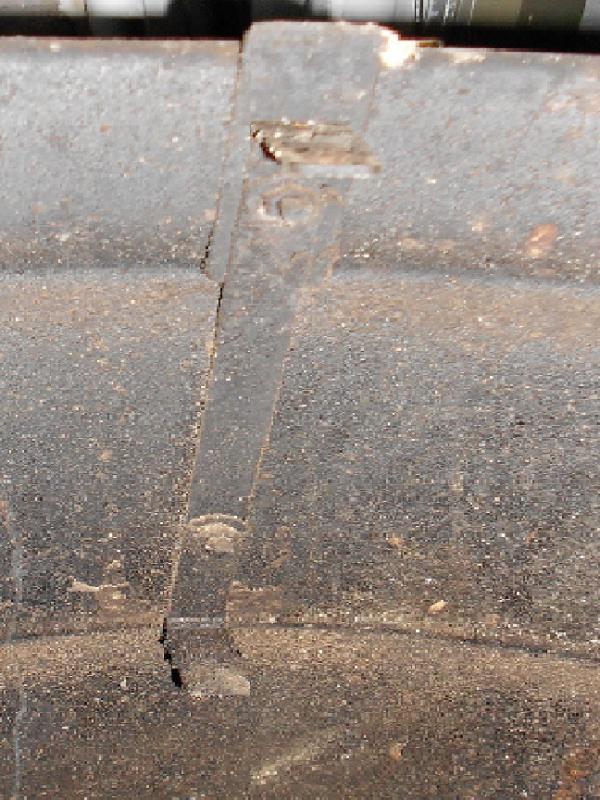

    I picked up a 4' piece of band iron at home depot to make FOUR of these grill shelfs, put them in with carriage bolts and I put in the top tabs to help locate the weber grill lid... There are four, 90 degrees apart inside the barrel, I dont have a very elaborate coal bucket like Hud crafted, but i will soon now... THis thing is all nasty inside with ash bcuz I turned it upside down to empty it out before putting it in the back of my wifes truck so I didnt make ANOTHER mess for me to clean up... Sorry for the bad pics...
    YOu could easily just use some 1/4 or 5/16 carriage bolts/nuts/lock washers to rest the grill on and skip the band iron grill shelf, just rest the grills on the ends of the bots... That would work just fine, they would have to extend inside the barrel about 1 1/2 or so, I would put them in 90 degrees apart...
