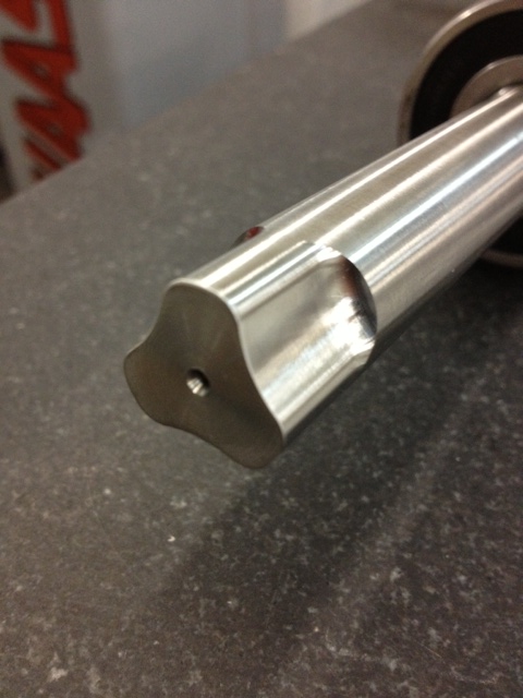

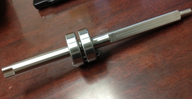

    Okay, here you go. The drive end of the shaft to mate with the cam drive. Shaft is made from A-286, all diameters ended being .0007 total run-out. It has 2 large bearings in the center of the shaft with a .0003 press so they won't be too hard to get off if they ever need replacing. I gave it .005 clearance on the male to female fit of the drive end to allow for any misalignment when it all goes together.
    Attachment 36573
    Attachment 36574
    very nice i can sleep now trying to figure out going from a 1 bolt cam to a three bolt.. piece of cake for you... very very nice job

    Micheal, I'm not sure what you're trying say here. Unless you're refering to making one of these deals for your Chrysler. But you don't have to worry about the shit I make, it's 100% quality shit, until it breaks.

    what aim saying is that when i need some that is true quality and precision i know where to go
