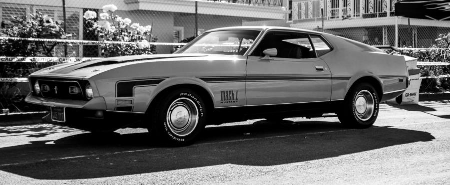

Thanks TMM! That old Mach 1 has been very good to me.
