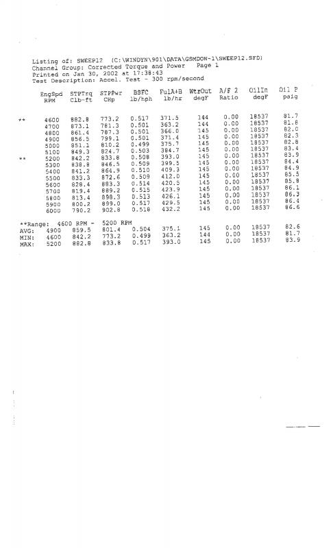

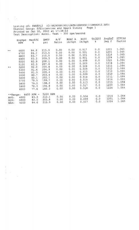

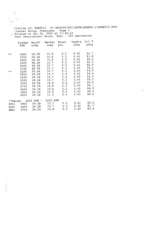

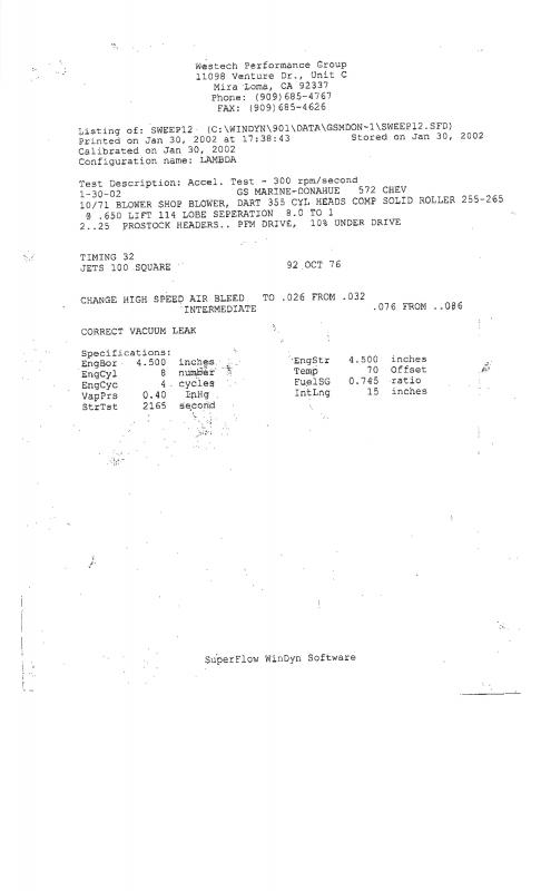

    Dan Douglas faxed me over the first Dyno Sheet from 2002 with 5 PSI. He didn't find the one they did with 6.5 PSI.

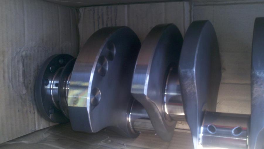

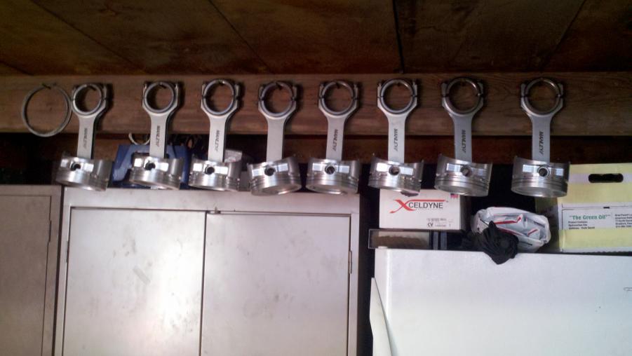

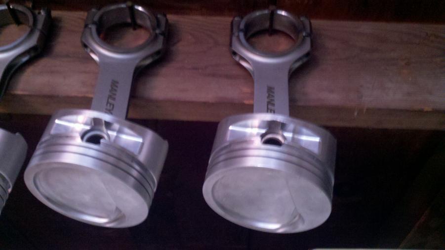

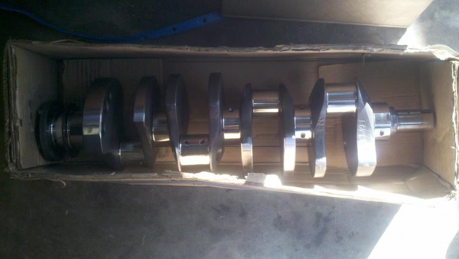

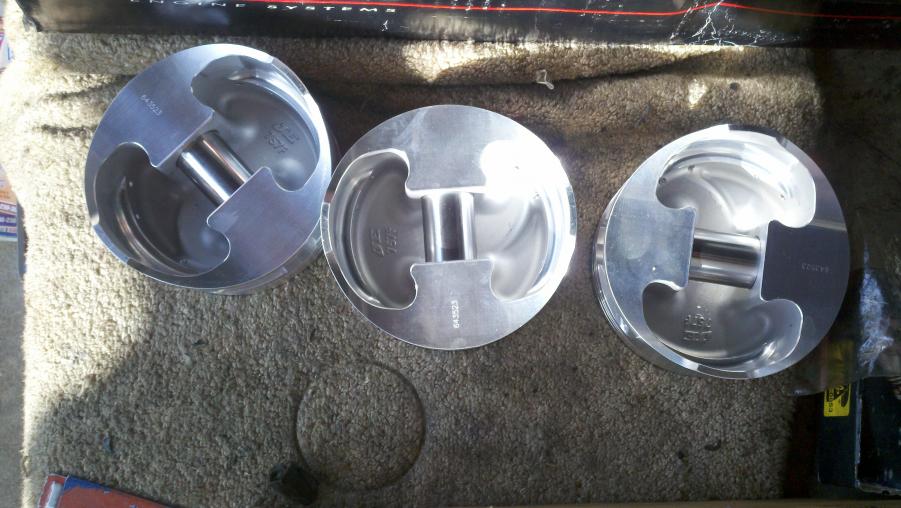

    Lew got the rotating assembly back from the machine shop. The engine is now an internally balanced engine instead of internally balanced on the front an externally balanced on the back of the engine.
