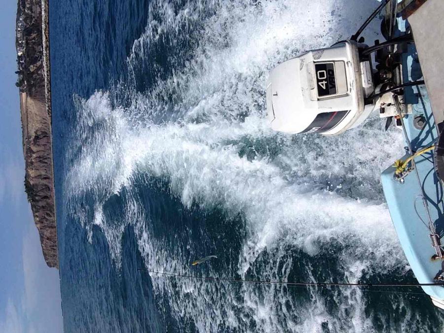

Here's the only picture I have of it at the moment....not sure if it helps.

You have bigger problems than just the alarm. It looks like your whole world has gone sideways.
Its the new Pacific Intercoastal Vertical Waterway. Its a bitch to get on, but once you're on its a helluva ride
