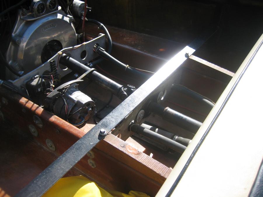

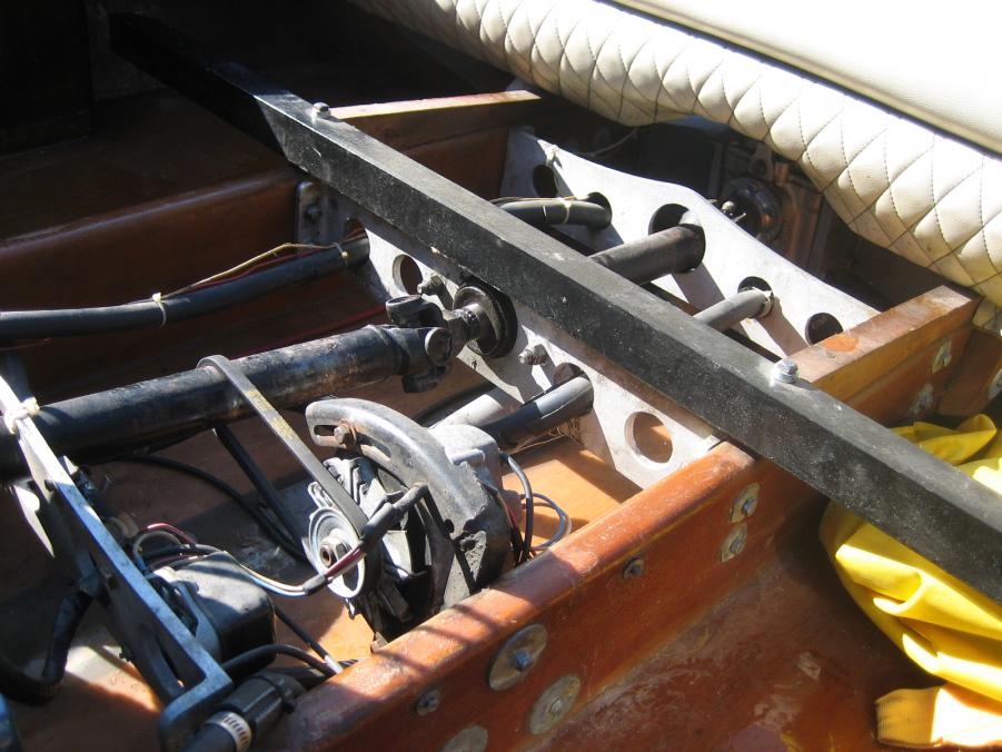

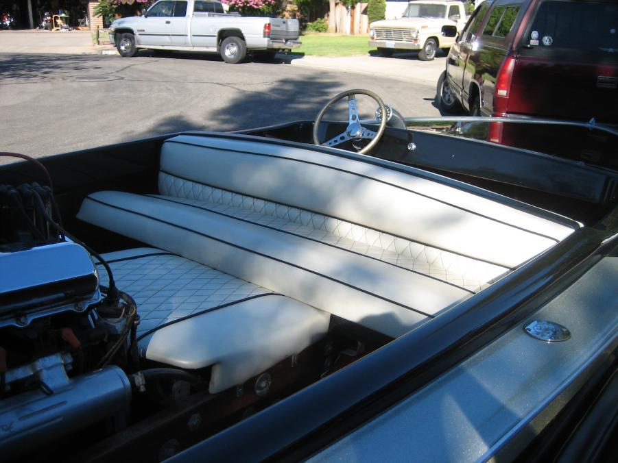

    To maximize space for seating, skis, vests, ropes, coolers, etc., he used simple back-to-back bench seats with a center cover over the driveline and alternator from the motor to the back seat. It comfortably seats 6 adults (or 2 adults and 4 or 5 skinny little kids). To keep the driveline low enough to allow for a rear bench seat, he installed a Hallibrand parallel shaft gearbox (V-drive). I’m not sure if he was aware of just how miserably loud the straight-cut gears in this box are or if he chose that particular unit to save money. As with most v-drive boats, there is no reverse gear: it is either in gear (forward) or out of gear, requiring exceptional spatial awareness and good aim maneuvering around other boats, docks, skiers, rocks, trailers, etc. Smitty’s setup here was to use a 2-piece driveline out of old Studebakers for this application. The alternator is bolted to the inside of a stringer with the v-belt simply spinning on the rear driveline tube.

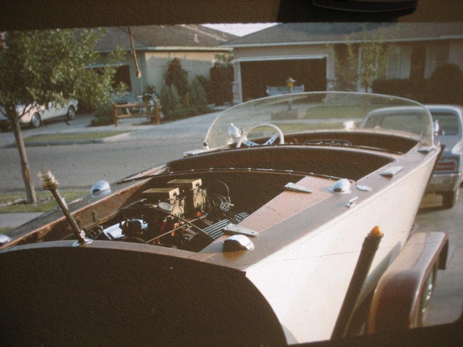

    Smitty loved to use big Cadillac or Lincoln motors in the bigger boats. I’m not sure what he put in the first flatbottoms but I know they were not Oldsmobile’s. Yet, that is what Dad bought. Dad had an uncle that I don’t remember ever meeting, who owned the Cadillac / Oldsmobile dealership in Fresno. Dad was able to order a brand new 425 cubic inch big block motor from the factory through Uncle Phelan and I remember it showed up in a wood crate. With the low strung driveline setup, they mounted the motor very low in the boat at the front mount and just far enough forward to allow for a long, thin battery to be accessible behind it. According to photos, the first carb on the motor was a Rochester. In 1968, it is the Carter AFB. Dad was very proud of the black wrinkle paint he used on the motor, which is now pretty tired. He also loved the clear, see-thru spark plug wires he made up back then because they matched the metal flake silver trim on the hull.

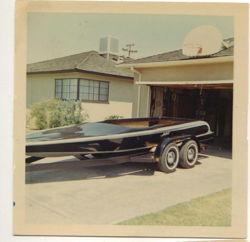

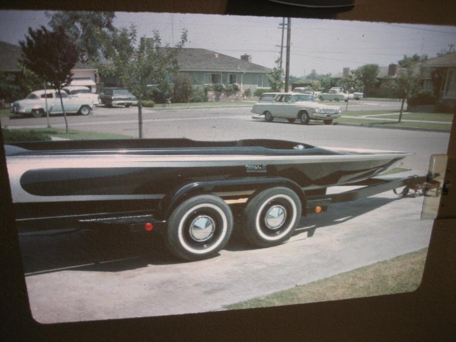

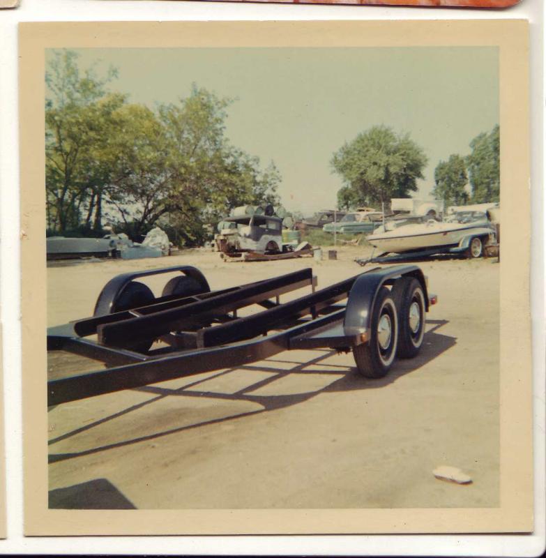

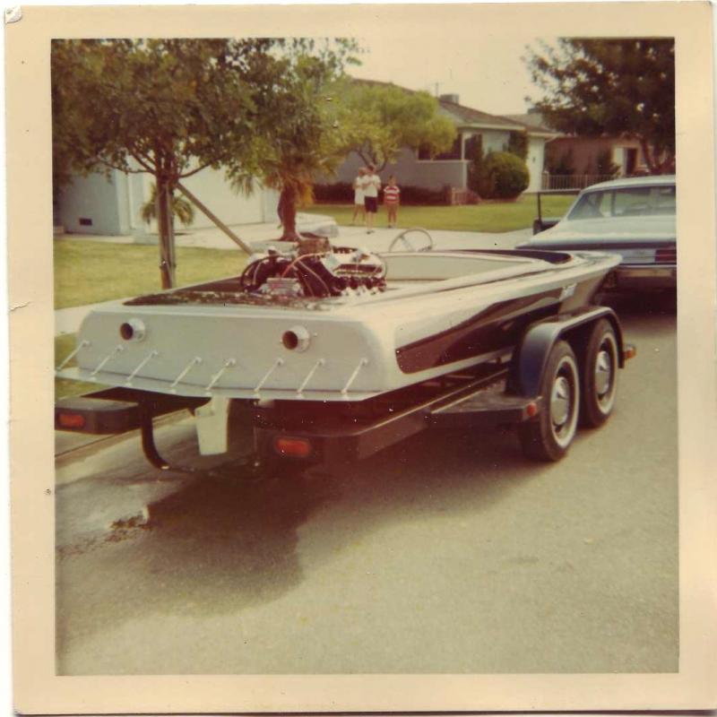

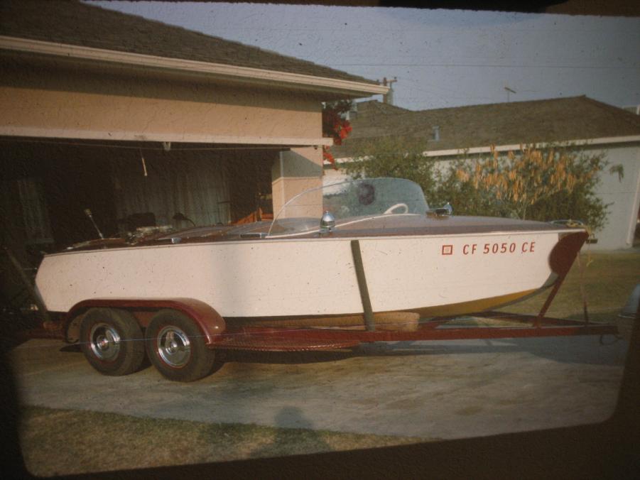

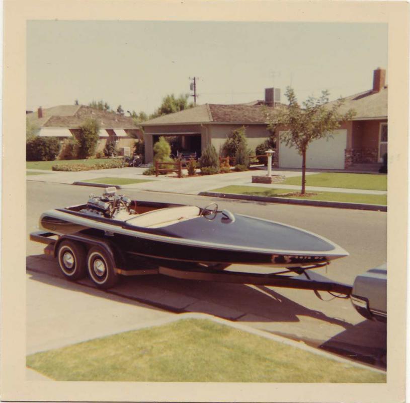

    Note re photos: The Aug 67 Terri skiing pic shows the old Rochester carb Dad's fancy see-thru spark plug wires
    The 8/68 pic of Mom climbing back in the boat show the Carter with Dad's custom made spacer/adaptor
    The pics of upholstery/driveline/alternator/battery were taken last year and used to show what I was referring to above
