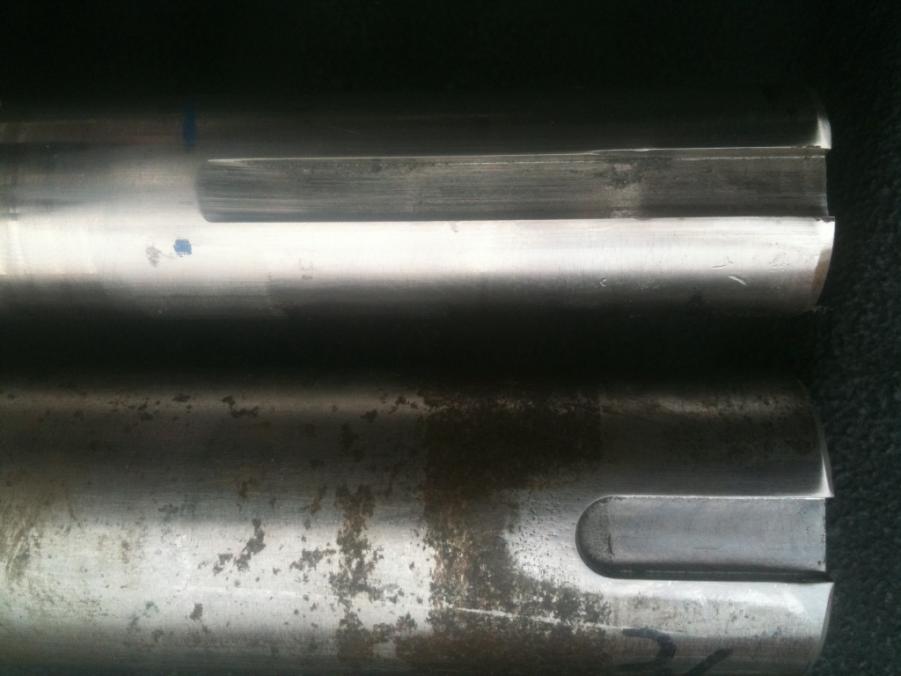

Two different style's of machines and tooling used to cut the keyway's pictured. Is one of them less prone to develop a crack at the end of the cut?
I don't like either one of those slots. Both have zero fillet radius. My opinion, they should have .040 minimum fillets. But between the two, I would take the shaft cut with the endmill(bottom) less work hardening with this process. I feel the slots on the prop shafts should be cut with a ball endmill and the key should have the same full radius shape.
Thank you for the response. I've never seen key stock radiused on one side to match a ball endmill slot. Is that common stock? Can you explain to me what fillet radius is and the benefit of it?
