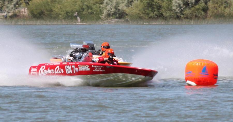

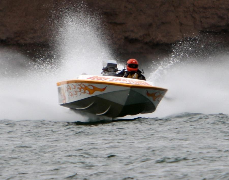

    Nice shots HBCHGRL!!!
    Name:  gn24 NEW 2.jpg
    Name:  gn7 burley 2012.jpg

    Thanks! That first one of Body Snatcher is a great shot!

    Who can name all these drivers?
    Depending on the exact year.
    can't tell you is in the first boat.
    next, looks like it could be a Rush.
    3rd Lanse Haselrig GN790
    4th either Bohana or Skip Tuttle GN711
    5th Mike Hoban (rip) GN 30
    6th No clue
    7th I'll go with Paul Fitzgerald, but it could be Dave Rankin. GN9
    8th No clue

    Here's a few more from Castaic and Mission bay.. I think 6 is Teague and 8th is Bonici's boat with previous owner. (I can't remember names.)

    My all time favorite GN, Bill is an awsome driver, he dives that thing into the corners like nobody I've ever seen
