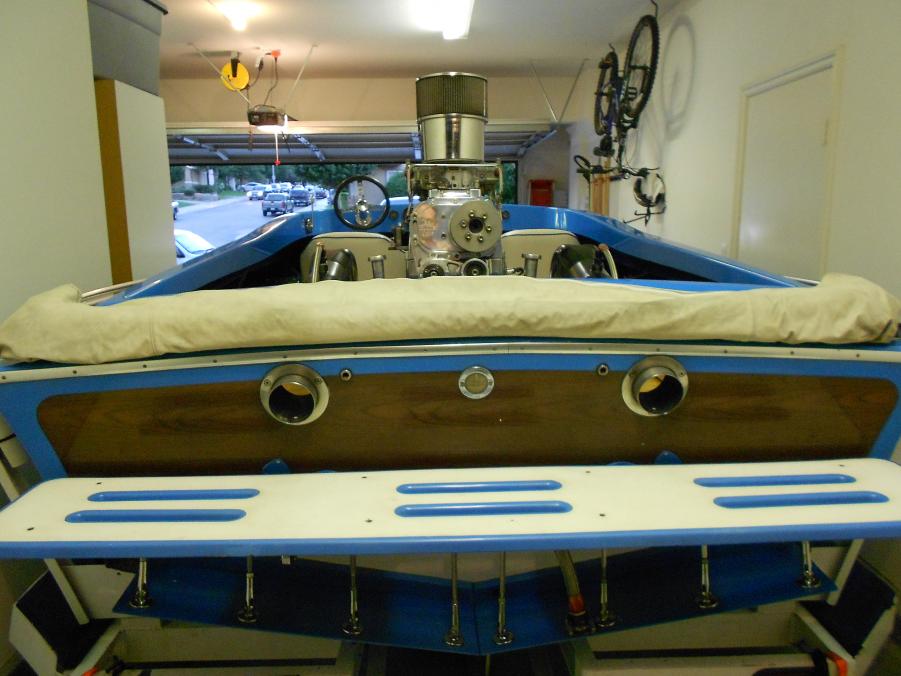

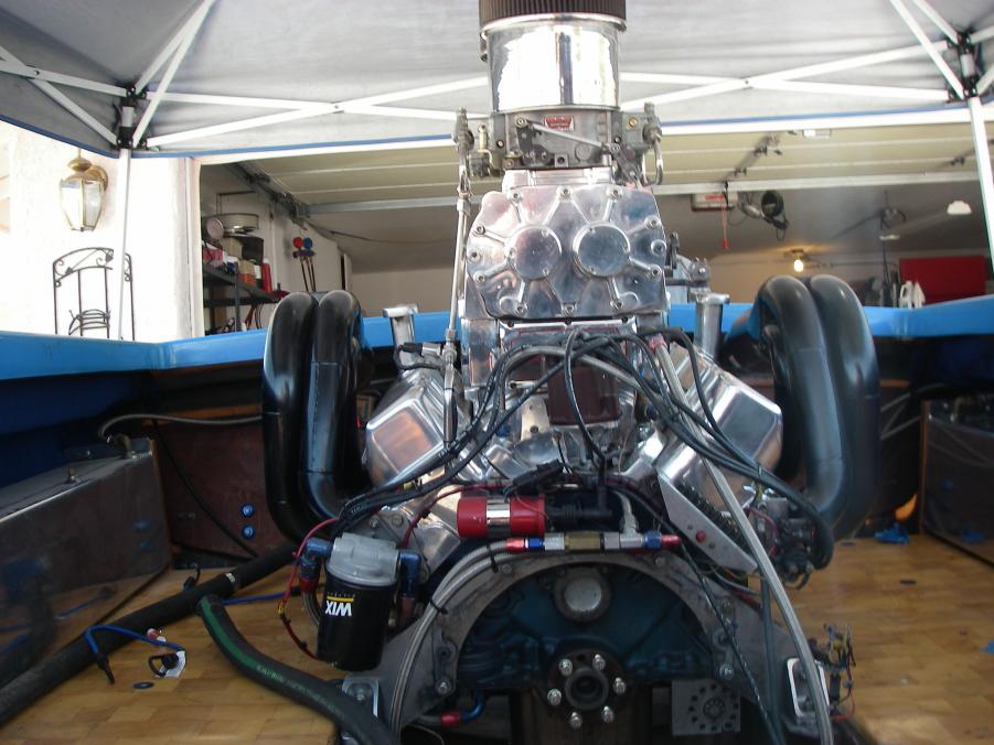

    I didn't really know much about the boat the first time I went for a ride the boat it had an Olds but I knew that Greg bought Danny Donahue's (RIP) old engine and that he had re-rigged the spectra in 2007/2008. I also knew that Greg had done some work to the bottom.

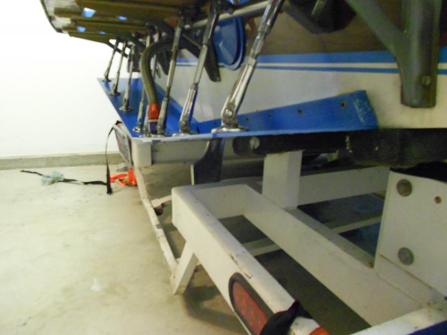

    When I got the boat home I measured the following: The strut angle is 7.8* with a 6" drop. The distance between the transom and strut is 25". The cavitation plates are 9.5" from the transom and end 7.25" from gunnels. The distance between the engine and transom is 20". The centerline of the gearbox is 100" from the transom, 4" from the bulk head and about 15" from the deck/dash.

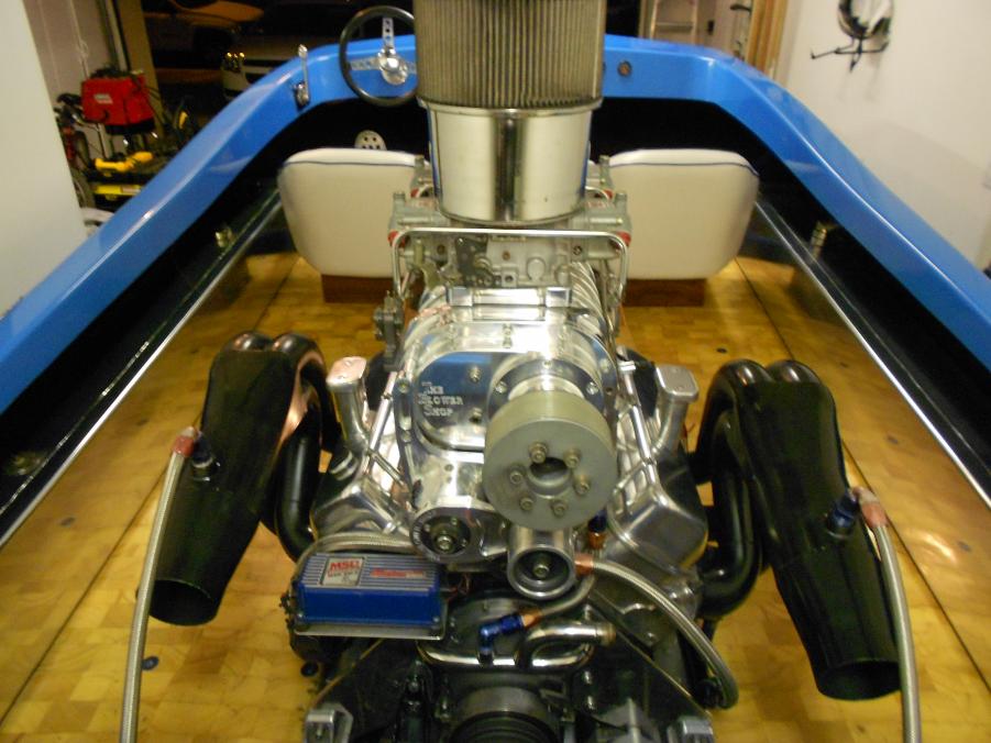

    In 2011 Greg finished the Balsa Veneered floors, added bucket seats, Calgo steering, a down pedal and polished clear powder coated the aluminum fuel tanks.
