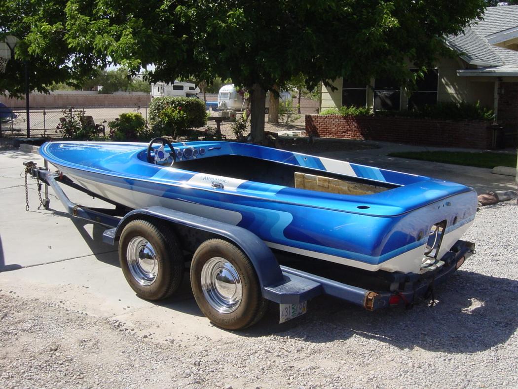

    So, last season, I was going to be out of a ride and was really bummed. I had been watching this 18 Advantage open bow, that was for sale. I knew this boat and have always liked it.
    So I called the owner and made a deal to go down to Laughlin and pick it up. Here is the funny part! Just as I was getting ready to walk out the door, to go pick up the Yellow Open bow, I decided to have a quick look in the spam section, on PB and there it was! River Dad had posted up a blue closed bow 18' Advantage hull and trailer. Now I had been looking hard, for a 18 or 19 Rogers Bonneville, for almost a year, and there it was, the next best thing, an 18 Advantage bubble deck, laid up from the same mold as the 18 Rogers Bonneville.
    I immediately sent Jason a message, telling him that I would buy it sight unseen! So I bought two boats in one day

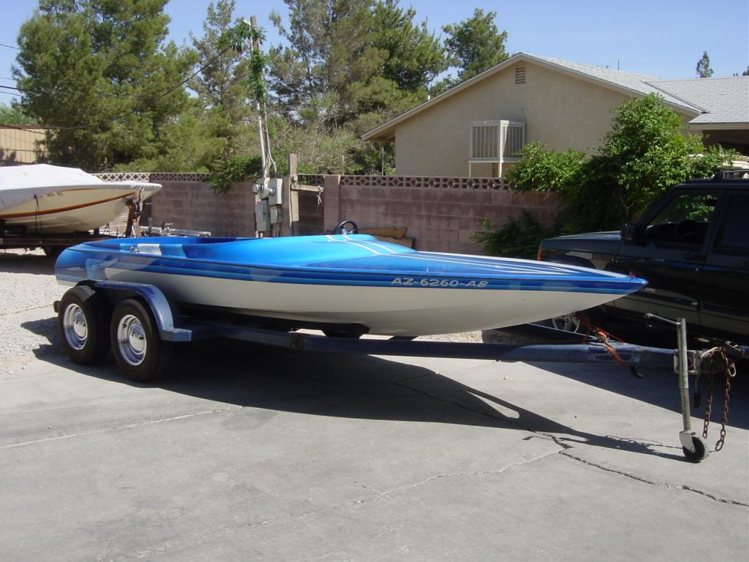

    So here it goes. The wife and I hauled ass up, from Vegas, to Jasons shop, Roke Trailers, in California and picked the thing up and drug it back home.

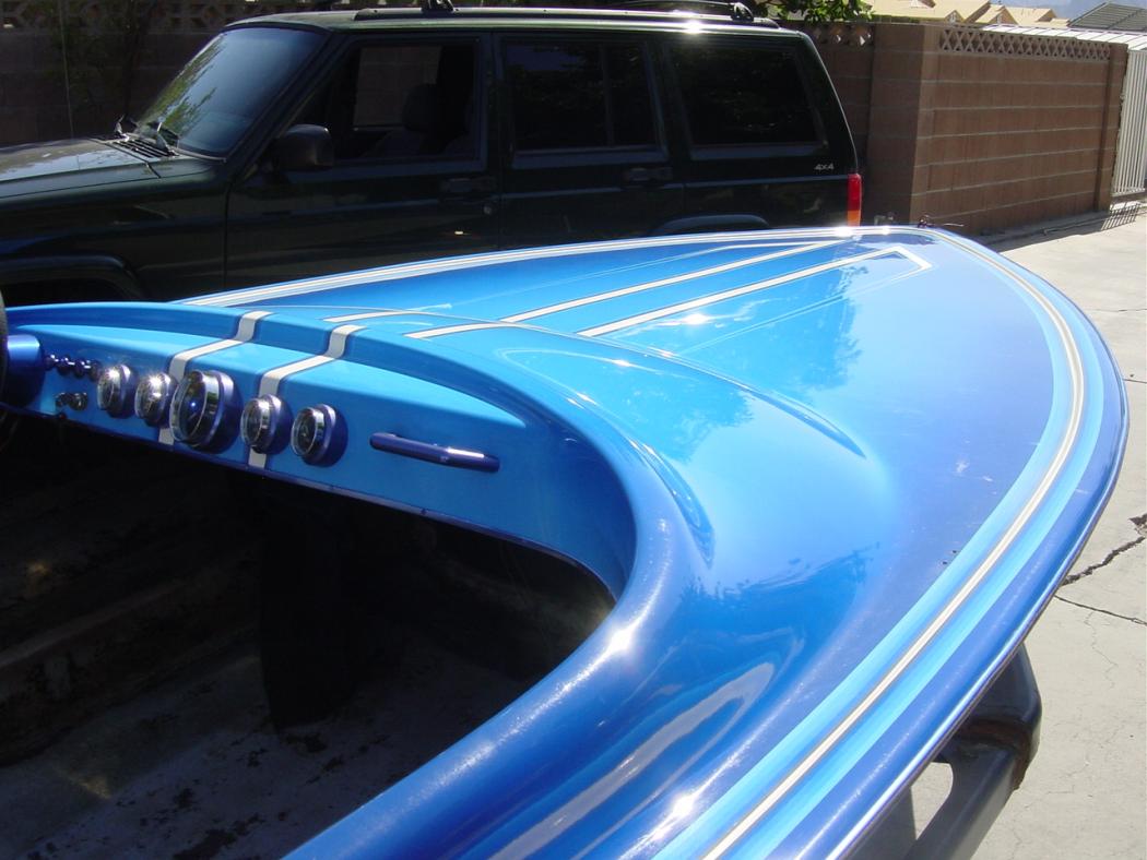

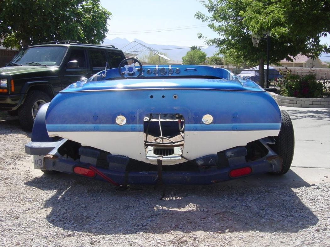

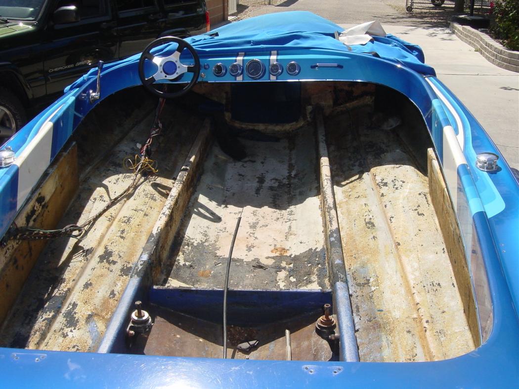

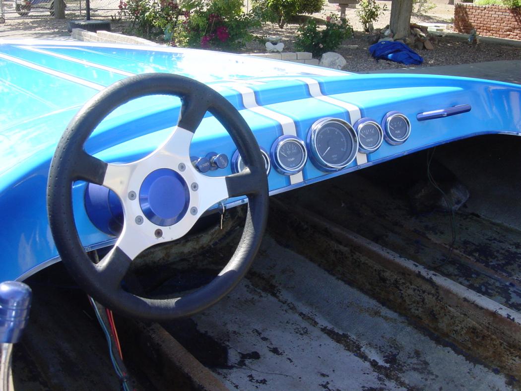

    The good. It is the hull that I wanted, The gel is in pretty dam good shape, the stringers and floor are in good shape and seem to be solid, and it has a pretty straight and solid Competitive tandem axel trailer, under it.
    The Bad. On the transom, there is a sun faded spot that has faded thru to the base, there are hardware holes all over and one of the fiberglass fenders has been blown out. Sounds like fun right!
    Here are a few pics from when we got it home.
    The good!

    Ok so for the bad. The faded spot and the holes that I will have to do some creative covering on.

    Oh yea, and the rotten bulkhead

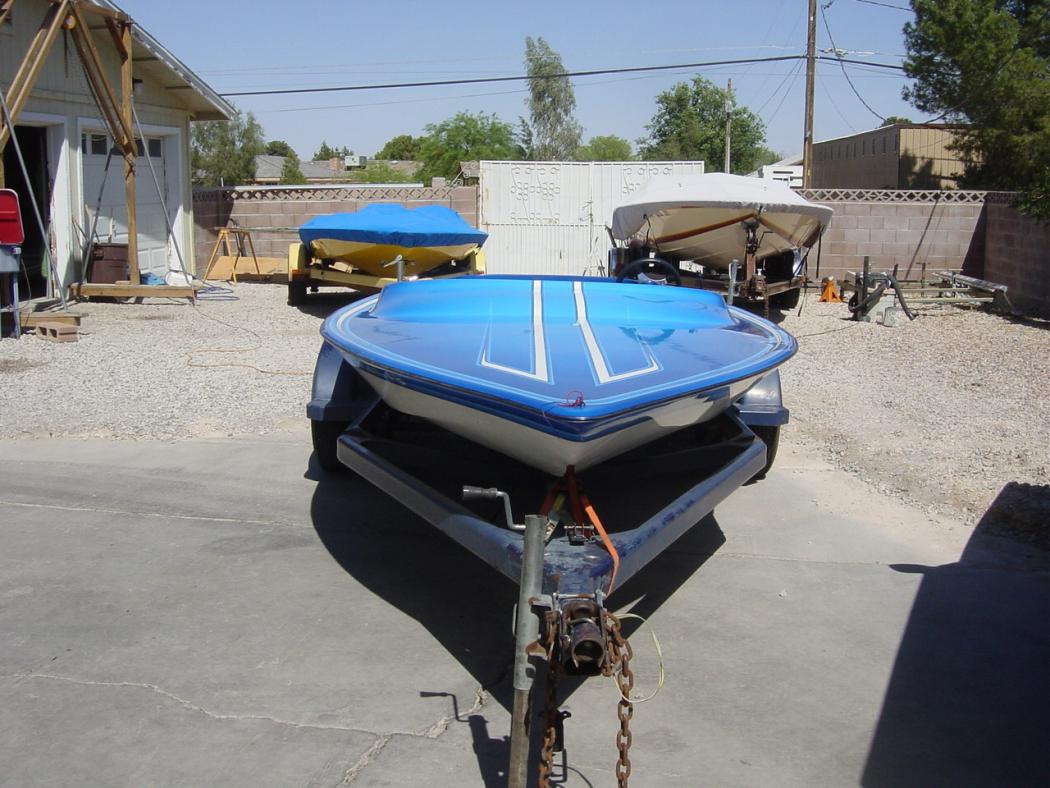

    The trailer did not fit this hull, so I had to rebunk the trailer. I had to cut off the old bunk brackets, and fabricate new ones and re weld them in the proper position.
