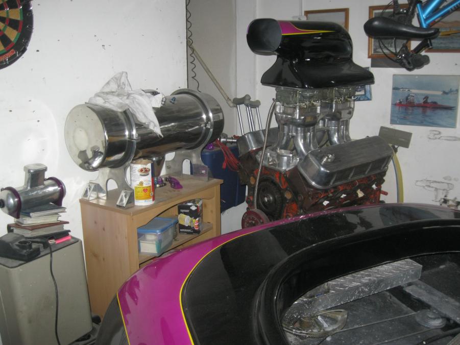

motor stuff

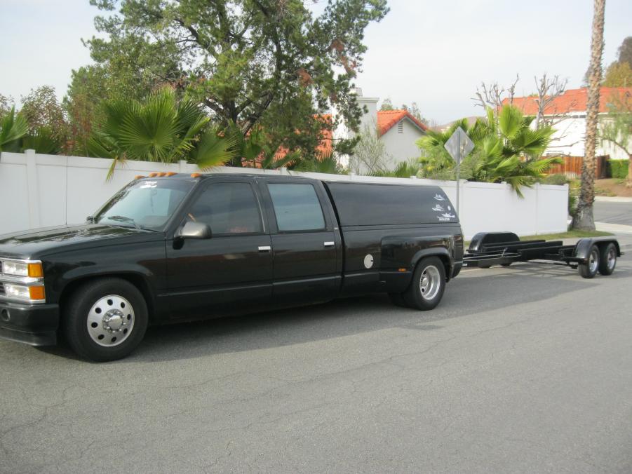

tow vehicle and stevens trailer..............also the biesmeyer trailer will be black and the biesmeyer will be painted the same colors as the stevens except the pinstripe will be lime green instead of yellow.........and a different stripe design.....so they will kinda look identical side by side in the water......
