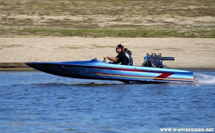

My Gondo GT has the traditional bottom. never seen the 3/8 bottom on a GT either. Any pics of the actual bottom.
Here is mine, photo credit to Sharp Shooter!

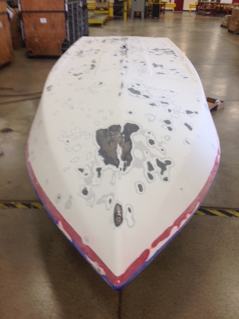

Hello Brian,
I've seen your boat on Performance Boat and I love it, the stack injection is too cool!
I'll snap a pic of the bottom as soon as I can and post it up for you. If I'm not mistaken the bottom on my boat was the XH511 and the deeper runner on your boat was called the XH511T. According to all the info Jim Lange has posted on PB about the history of Cole bottom design, the Cole TR-1 was a splash of the XH511 while the Cole TR-2 was a splash of the XH511T.

It's been a while since I've updated this thread so I thought I'd post a few progress pics.. First up, got the bottom all fixed up and looking good again.
