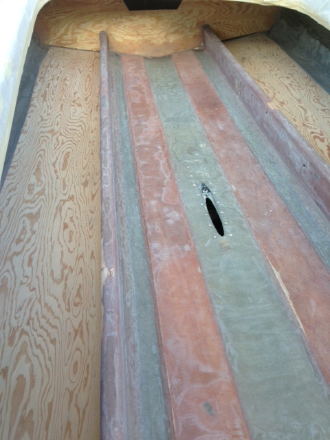

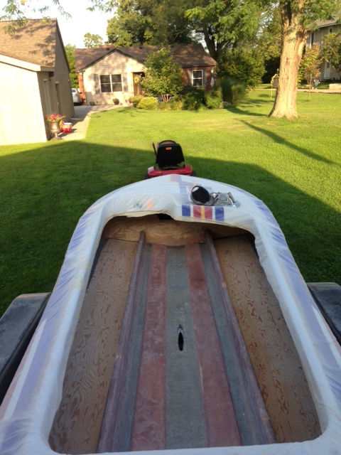

After we got it home and took a good look at it we decided all the hardware needed to come out and replaced, it was all well worn after it's racing career. Also decided that the floors needed to be refinished, found some delam on the stringers in spots plus the floors just looked bad so I started grinding fiberglass.....
What a horrible job and I will never do this again - much of the summer of 2013 was spent being very itchy from fiberglass dust.
The original wood looked good after all the grinding, too bad I made a few rookie mistakes and ground through the top layer of it in a few spots. So I laminated down a layer of end-grain balsa and got some epoxy / cloth back over the floor by late fall. I went with epoxy because it's easier to work with, doesn't stink and is supposed to perform very well.

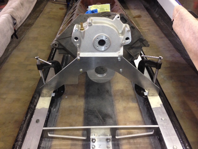

After the epoxy cured I started finish sanding in preparation for flow coating, I decided that I should start fabbing the new hardware before the final flow coat so I wouldn't have to worry about scratching it.
 [ATTACH=CONFIG]
As you can see, everything is going to be new.

Looking good! How much of a runner is under your boat? Is it the normal 5/8ths? Looks shallow in that last pic...
