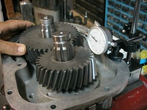

    Quote Originally Posted by HotWater View Post
    990hp is pretty good! I think a regular casale case can take about 37's with water jackets.
    according to andy at casale 29 is all you can get , before you remove the water jacket he rebuilt mine when i did the motor and that was the max gear before it hits the case
    if i cut the case it will run to hot on a river lake boat
    see the 29s almost touch the water jacket

    Quote Originally Posted by ogshotgun View Post
