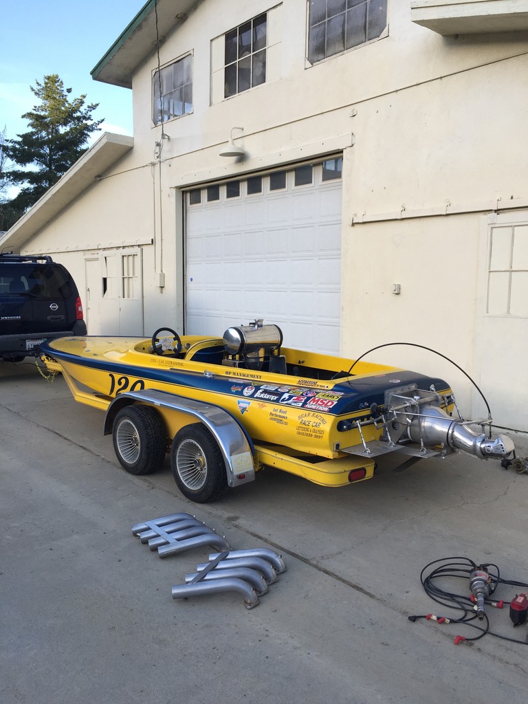

    Here's a Rogers drag boat I recently picked up. A lot going on with the plates on this one.
